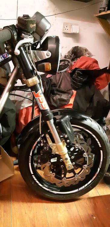

  4. Went out for a test ride yesterday and it all works very well. The front brakes are fantastic and my only criticism is there is not enough lever travel for my liking which I will sort out. A few adjustments needed to re-route throttle cable as the revs rise a bit when the bars are turned full lock to the right, as well as the mudguard going black when the weather warms up the brake calipers will also be painted black.

  8. After a bit of fecking about with the bottom bearing, problem was the R1Z bottom bearing is shorter than the SZR one, so with the new r1z bearing fitted to the bottom yoke the yoke rubbed on the frame, was an easy fix but did require another new bearing. I made a 5mm spacer made out of a moped clutch nut to sit under the new bearing. Also done the lock stops which was a simple drill tap and nut and bolt job,basic but does the job superbly.
  9. I have started to fit the SZR66O front end to the R1-Z
