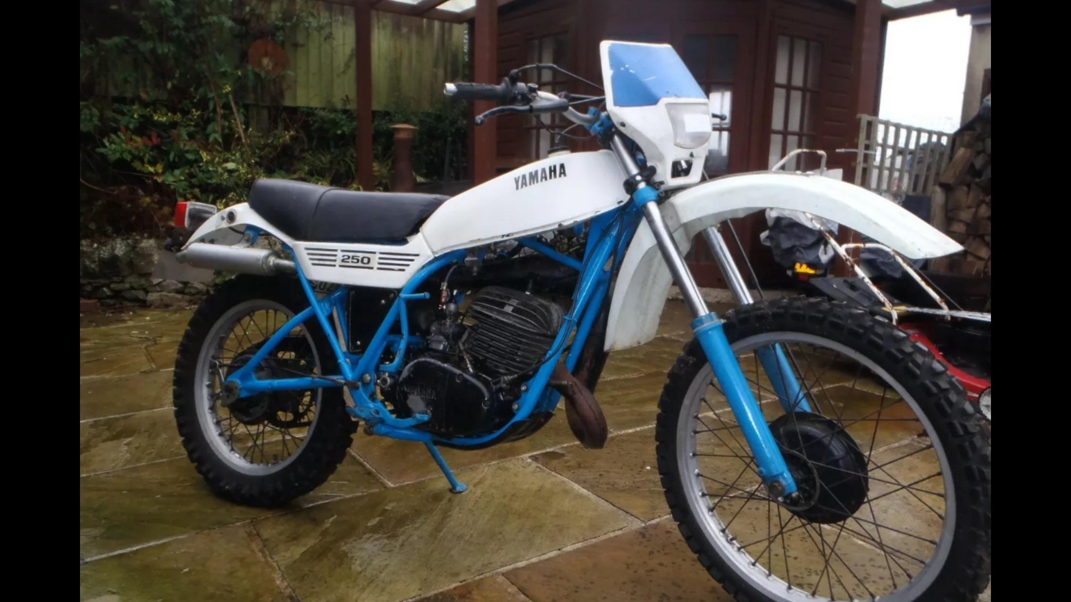

  4. Hi. I have just split my casings and replaced all bearings, I have rebuilt the casings and all the bottom end. I have started filling gearbox with oil and after 1/2 litre it reads the correct level on the dipstick, the manual says the capacity is 1.1 litres. Any ideas on what ive done wrong would be greatly appreciated. Thanks in advance. Graham

  7. Hi I will probably be leaning on you a lot as I have had no dealings with them at all. always liked them as a teenager but that was 40 odd years ago. have just restored a Honda xl250s and really enjoyed doing it. in theory this should be easier but struggling with getting it going as it has no spark and the stator was in pieces in a cardboard box so not sure if they are the right bits or not. they did all fit together though. 👍
  8. Hi I'm a new member, just thought I'd say hello. my name is Graham and I've just purchased a dt250mx that I am hoping to restore. it is a non runner at present but I'm hoping to start on it in the year near. anyway just thought I would say Hi and hope you all have a happy new year. cheers Graham
