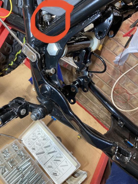

  18. Hi NEO Thanks for your reply, yeah mine is different. The brake switch is the back side of frame and the pedal has no hole for spring to attach. I have attached some photos but no matter which way I position the linkage it doesn’t work. It actually pushes the spring in when you push the brake on. where I have put the red arrow. I wonder if that bracket will help in some way? further investigation is needed. thanks again NEO
  19. Hi everyone I am trying to connect the rear brake light switch and the linkage from the brake light switch to the rear brake pedal has got me scratching my head a little. it is the linkage from the spring that returns the brake light switch plunger to normal after the rear brake has been released, there is a fixing that fits on the rear of the pedal with a connecting rod on it to connect the spring, no matter which way i position it the movement is the wrong way. it has been a year or more since i dismantled it and i am not sure this is even the right bit as I cant find the linkage on cmsnl. a photo of someones linkage would be appreciated. or a photo of where the springs attaches to. I hope this makes sense cheers Graham
