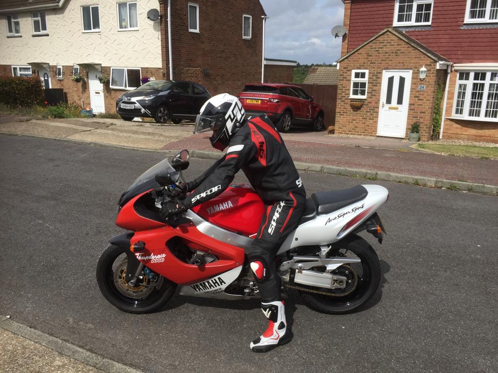

  9. Hi all - can anyone give me an idea of a realistic alternative radiator for my Thunderace please? I'm fed up with aching wrists from the clip-on bars and heavy clutch so have opted to possibly junk the fairing and fit more upright bars. The reason to junk the fairing is the mirror supports are going to clatter on the higher, upright bars. This has led to the discovery of an awful lot of rat's nest wiring on show along with a radiator that's designed to be hidden behind a great big fairing which if removed reveals it in all it's glory with bit's and bobs poking out all over the place. Or should I just remove the standard mirrors (and supports), trim the fairing and retain it. If I remove the fairing there's an awful lot of mods to do including sort out the rats nest of wiring that's exposed, sort the radiator and source a headlamp fairing or some other means to hang the clocks and headlamp off. Have I just talked myself into trimming the fairing....??? Probably...

  13. Hi all, I've owned a 96 Thunderace which I really like but.....the clutch is really heavy. Anyone else have this issue or am I just a real whimp? I had an issue with not hitting neutral so replaced the clutch friction & steel plates, springs, seals at the business end of the push rod but although I can now hit neutral (most of the time) and despite all this, the clutch is as heavy as it ever was. I'm assuming early R1s would have a similar clutch setup and wondered if anyone else out there either is more manly than I or has a solution.....???
