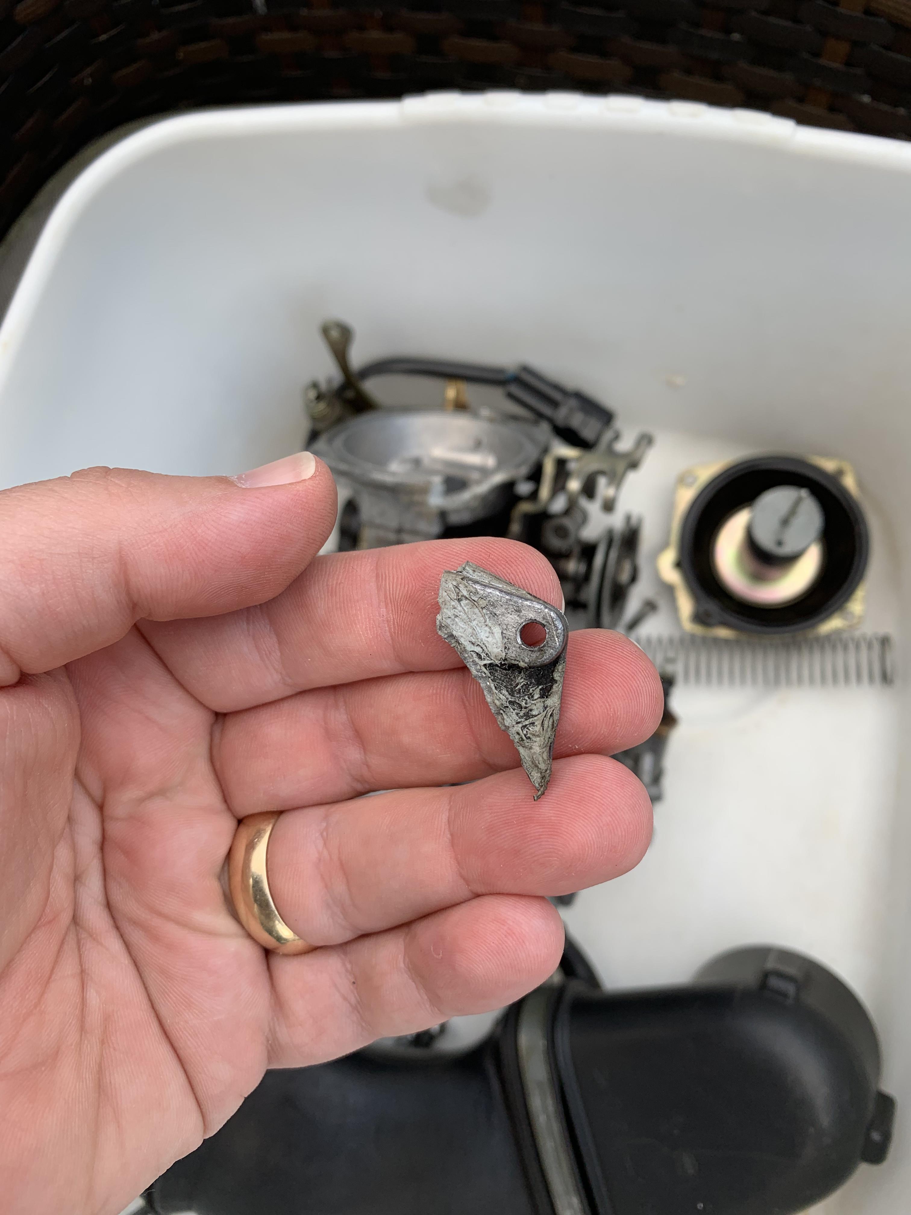

  2. Finally got round to getting the carb off and found that on the side with the diaphragm one corner had snapped off and glued up with exhaust paste... guessing this would cause the above symptoms. Anyone know where I can get a good quality replacement?
