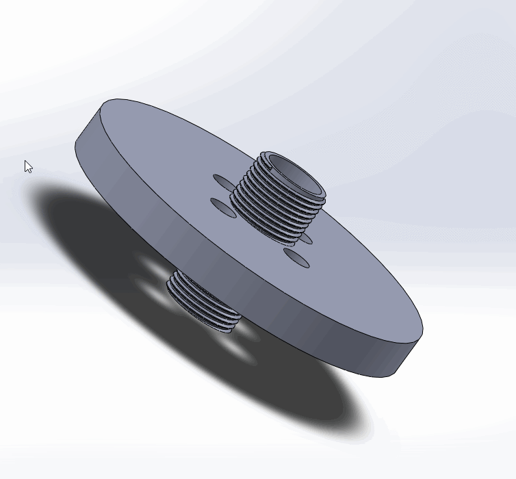

Yes, there are spin-on adapters for the XJ series, but it's just a plate like that. You still see the ugly filter sticking out the front like a wart. I'm going to make mine with a decorative cover. Similar type of construction, flange to flange plate with an M20x1.5 pass-through retainer. I'll have a cap that attaches to that plate, just not sure on the design of the plate and cap yet.- 1982 XJ550 Maxim Project

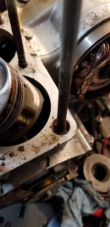

I'm having a hard time locating all of the cylinder/head studs for the xj550 engine. It seems that half of them are discontinued and I've already pulled all but the weird bevel-bottom one on #2, without marking them. ARGH! Is it possible to locate them in the UK? All of the distributors in the US have at least 2 if not 3 of the 5 part numbers unavailable.- 1982 XJ550 Maxim Rebirth

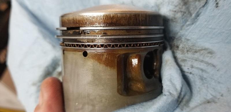

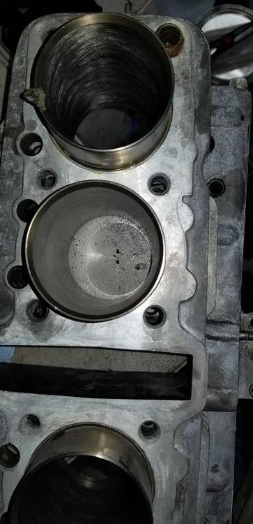

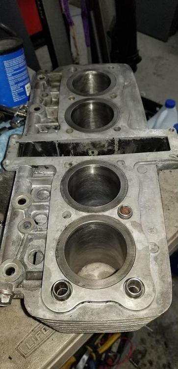

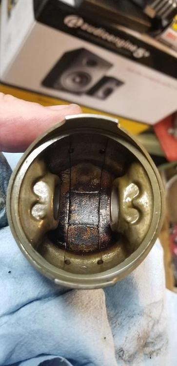

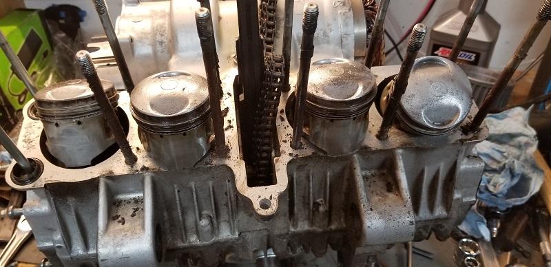

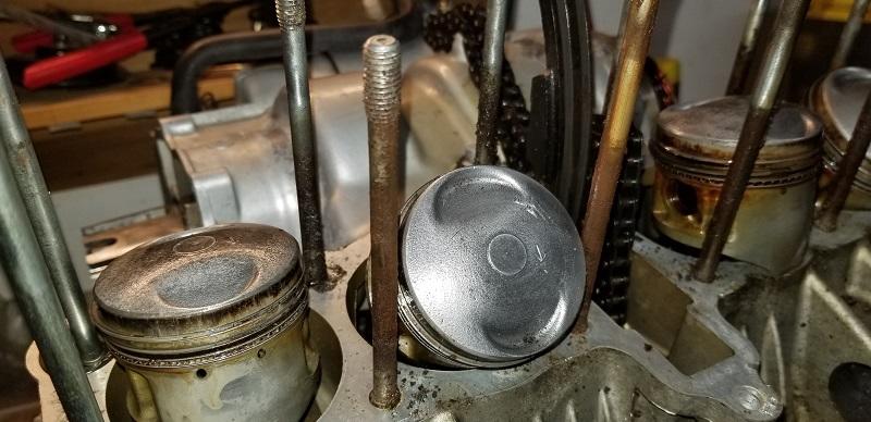

Ended up pulling the jugs anyway. Looks like the studs are rusted bad, guess they'll get replaced. Cylinder bores have been honed. Piston and rings look good, just gonna clean them up. Wrist pins were tight so going to re-install with new clips.- 1982 XJ550 Maxim Rebirth

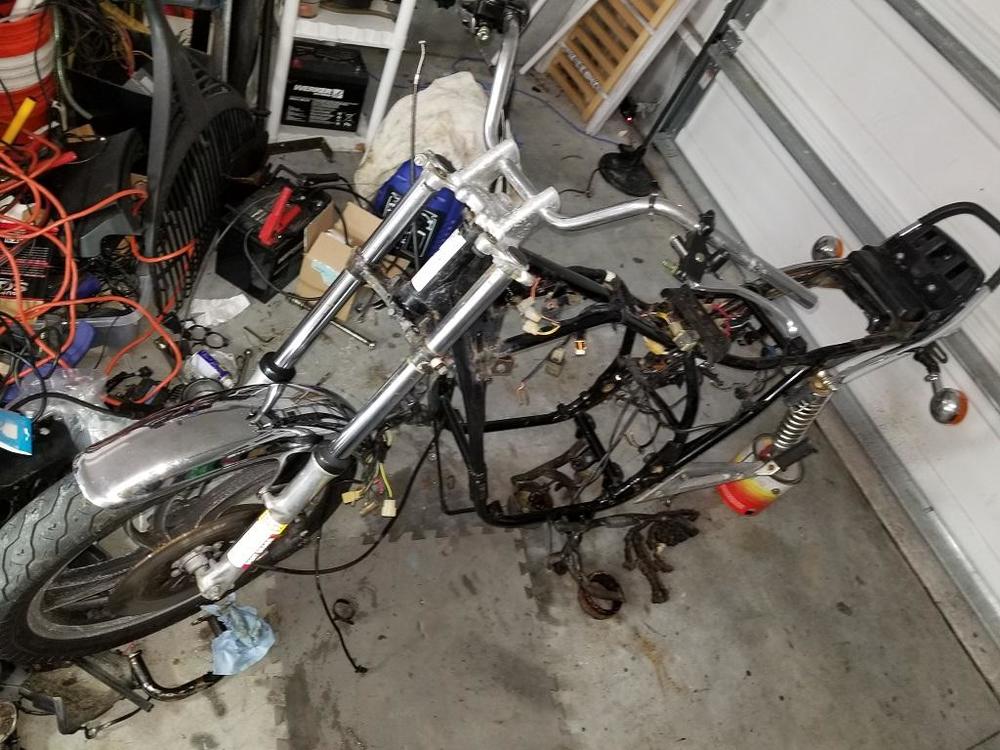

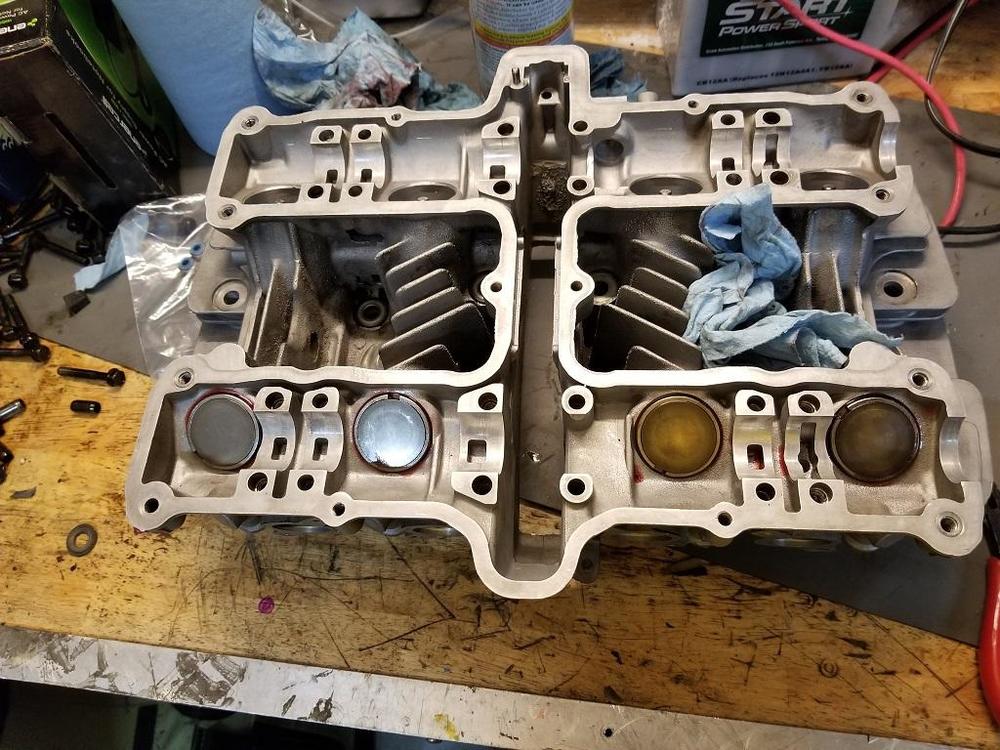

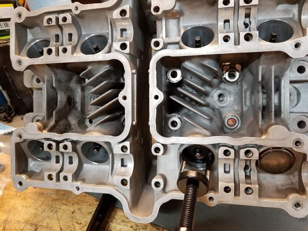

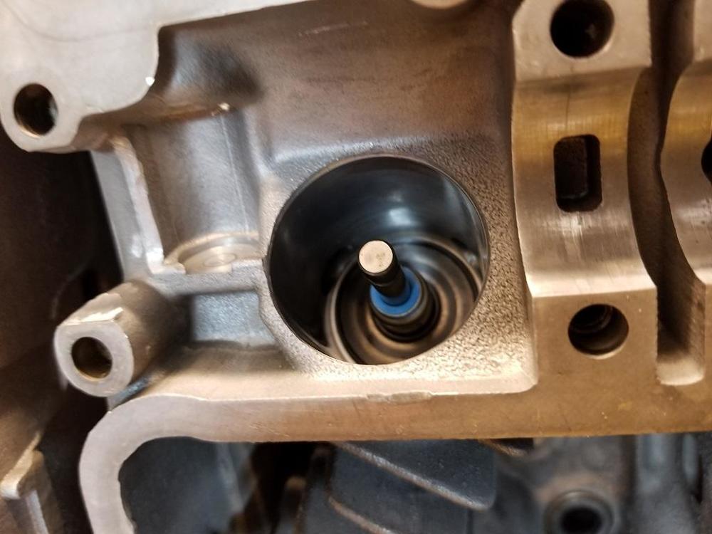

Lots of work is done and still to be done. The head and valves have been cleaned, new stem seals installed and valves lapped in. Cams will be here tomorrow and I'll finish the head rebuild. Engine has been cleaned about 50% and will be reassembled soon. The frame has been disassembled completely and is ready for sanding and paint. Someone broke the idle tube off for carb #4 so gotta find a replacement body and another idle jet. The other 3 have been cleaned and waiting for #4 before a carb kit is installed. I started on the gas tank with the stud dent gun and ended up chasing a hole with the TIG until I gave up. Too much rust causing burn-through so I'm working on a parts order for a bunch of parts including an undented tank, full harness, headlight trim, full lock set and various other stuff.- 1982 XJ550 Maxim Rebirth
Valves are in with new Viton seals and ready for the camshafts. WPC shipped the cam and I should have it early next week to finish the head work. Well, the frame is almost ready. The plan is to replace the harness since someone chopped it up. I'm going to get a replacement headstock sticker since all of the stamps match on the bike. I think for the time savings and durability I will get the local powder coater to handle the frame. I need to pull the head apart anyway and check all of the bearings. I'll eventually get around to the forks and front wheel assembly but I want to get the engine done and rear wheel done first. - 1982 XJ550 Maxim Rebirth
