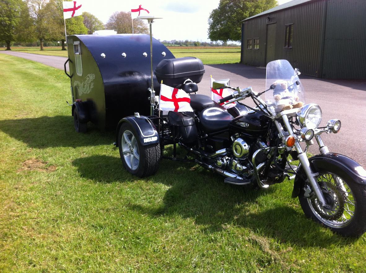

Hello everybody, I have a Yamaha 650XVS Dragstar which has been converted to a Trike. I bought a brand new all singing, all dancing battery for it a couple of months ago as the old battery was not designed for starting engines (I know nothing.) I've been using the Trike twice a week since then, the last ride out was Monday when it was extremely hot. I wanted to go for a run on Thursday but when I turned the key in the slot I got no reaction whatsoever. No neutral light, no engine warning light and no lights on the trike as usually happened. I checked the battery with a multi meter and got a 0.03v reading. I jump started the engine and when idling got 12.5v - 13.00v and under a load (revving) got a reading of 14.5v which I assume means the alternator is working??? I turned the engine off and waited a couple of minutes, took another reading which was 2.58v I waited an hour, took another and the reading was 0.33v which tells me that either the battery is knackered or there is a short somewhere draining it. I'm a very basic amateur mechanic, not into diagnostics etc. so can anyone tell me the best way to find a short (if there is one) or do you think the battery is dead and would the heat on Monday (the engine did get pretty hot) have done some damage somewhere? The battery was a Yamaha battery, which I got from a dealer who told me to perform the checks above but they haven't got back to me since. Any help, advice would be greatly appreciated. Thanks Larry
