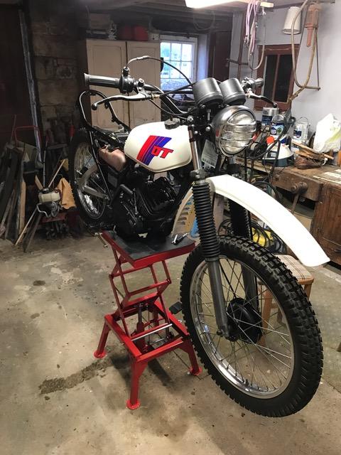

  8. Nice one thanks very much to you both for the recommendation. Will give them a ring for a chat tomorrow. Bore on the cylinder is like a mirror so doesn't need any work, am thinking about building it back up as a 175 , stay tuned Cheers, Ben

  10. Hi I got it from my local tools supply place it's a Sealey one and can lift 140kgs of there abouts. Was about £120 if I remember rightly, it's useful as I can put it under the bench when not in use.

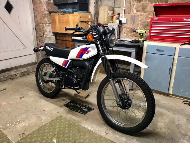

  11. Hi all, I've been a lurker for a while so thought I should say hello, I'm currently in my purgatory year on a 125 before being able to ride something larger. The new 125's left me a little cold so after a bit of research I settled on a DT125MX and found one that needed a few little things finishing off. Plan was always to get shot of it but have decided to keep it, silencer hanger bolt thought 50mph was a good speed to fail and sent the silencer skipping down the road at the weekend but I guess that comes with the territory! Thanks, Ben
