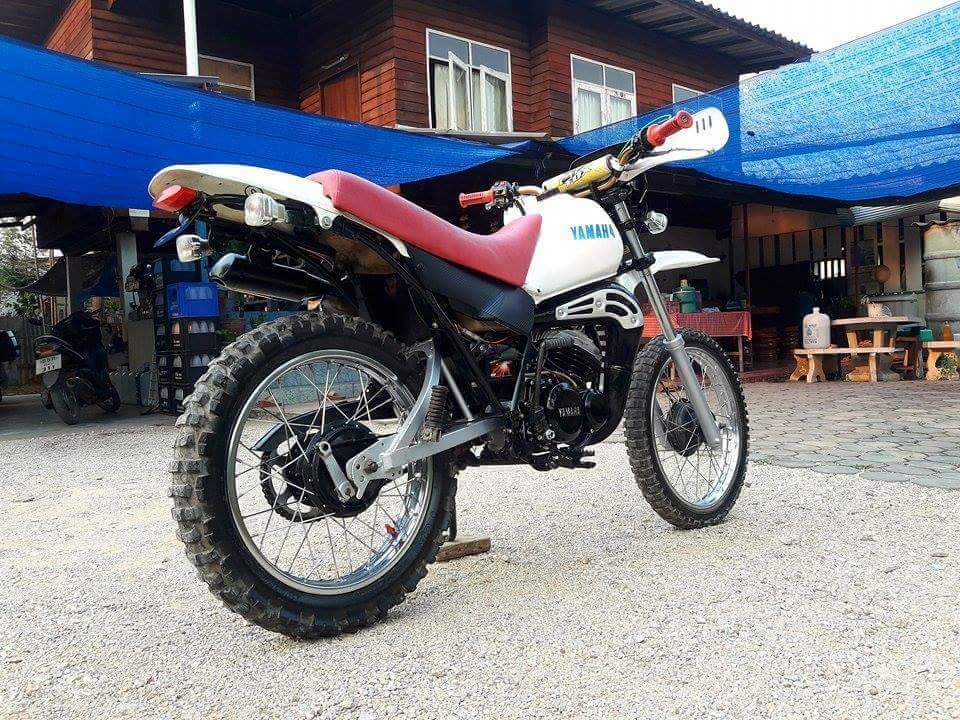

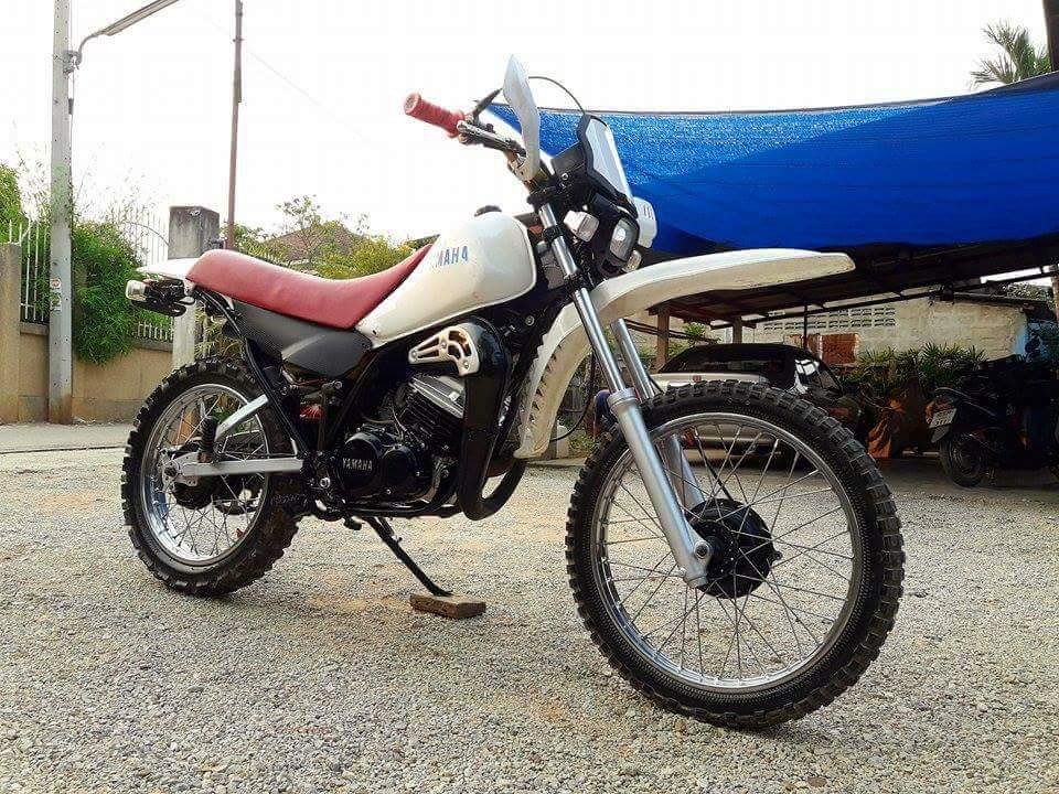

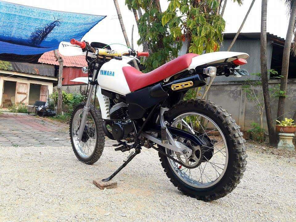

  6. Kfc posted a topic in Yamaha Workshop
    Recently purchased. Looking to get back to original. Or close. It's had its fair share of bodges by the look of it. Current on the truck going home. Looking at it I've got fuel leaking from the exhaust port. Going to have a good luck when I get home. Any ideas? Stuck float? Also can anyone point me in the right direction for parts I. E plastics original looking headlight. Anyou information on the model year and similarities or differences to older dt 175? would also give me better insight. I'm struggling to find a good source of information. Sorry it's long winded. Regards Kevin
