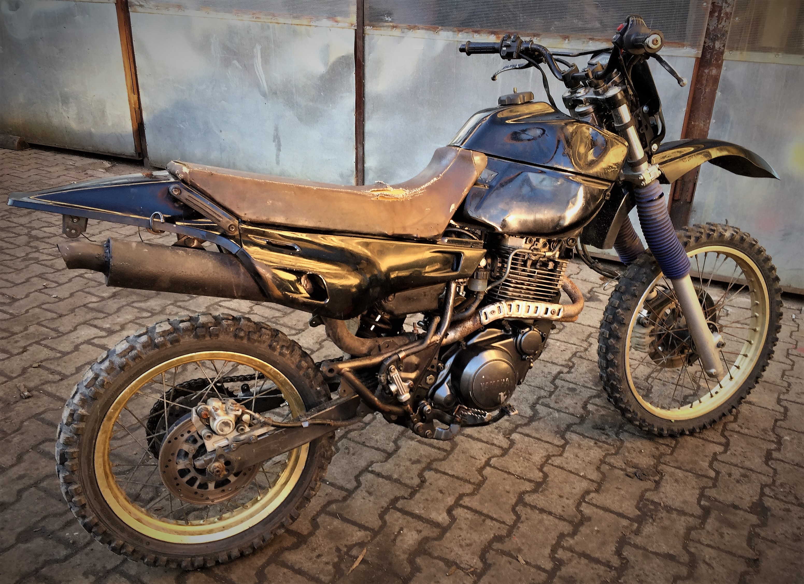

    I heard you guys like pictures please take a look at my work: Exhaust manifold: (did try to make it look better was treated with anti-rust) Silencer: (same as the exhaust manifold) Handlebar: (bough some second hands ones and painted them - I've sanded them down to the bare metal) Engine: (no bolt was torqued down ... and the piston slap is crazy will get a wiseco and a rebore + all the gaskets/bearings/o-rings) I've bought the one-way bearing and I hope it will last ! Seat: (this wasn't made by me but it was a nice restore for 10 euros). I hope you enjoy looking at old vs new (restored) pictures ! I plan on a full repaint of plastics and this summer will get the chassis painted also. I've already bought new tires (http://heidenautires.com/moto-cross-tires/k74/) and lots of other small stuff. The bike main purpose will be to serve my off-road rides and if it proves worthy on asphalt I will have it registered. I won't be driving on motorways only on old rarely used roads in the mountains either way. I've seen these bikes are capable of 140-150 km/h on good days. A question regarding the wiseco piston: - the compression is rated 10.7:1 and the OEM one is 8.5:1 ... I'm not looking for a power increase (which comes with more heat) so I hope I won't have any problems with the wiseco piston.

    Here are some pictures:
  21. bernek posted a topic in Projects
    Hi guys ! I've introduced myself and my bike in the new members zone and I think this is the right place to continue the discussion regarding the restoration that I'm planning to do on my bike. It's an XT 600E 3TB from 1994 with electric start. The bike is at a service shop for first maintenance and repairs since I got it but I plan on doing future maintenance and almost all repairs at home in the future. (I didn't want to mess up something with the brakes for example and have a small accident because of that and I preferred someone with deeper knowledge about four stroke engines to have a look at it first). There are a few important things to fix and replace including: - uni-sens bearing (will be replaced I can't start the bike at the moment) - carburetors are leaking (just found out today) I think its the pontou needle not closing (will be fixed or I will have to fix it myself). - there might be a timing issue (some misfires at low to mid rpm) or an overly rich condition that I suspect is because of a too high level of fuel in the carburetors. Will have to adjust/fix. There are a lot of smaller parts that need replacement also but I don't think its important to enumerate them here. (most are cosmetic parts). Regarding this uni-sens bearing I'm not sure what to do ... buy a new one or get a second hand replacement. It is very expensive (for me) and it will take a big chunk out of my budget. I have some other things to change also including tires that wont be cheap. The bearing only arrives in 3-4 weeks and the price is 160 eur; a second hand one would cost me a merely 50 eur and is available in 2-3 days. Like I've stated in my first thread I want to make it work as it should first then move on to cosmetic part.
