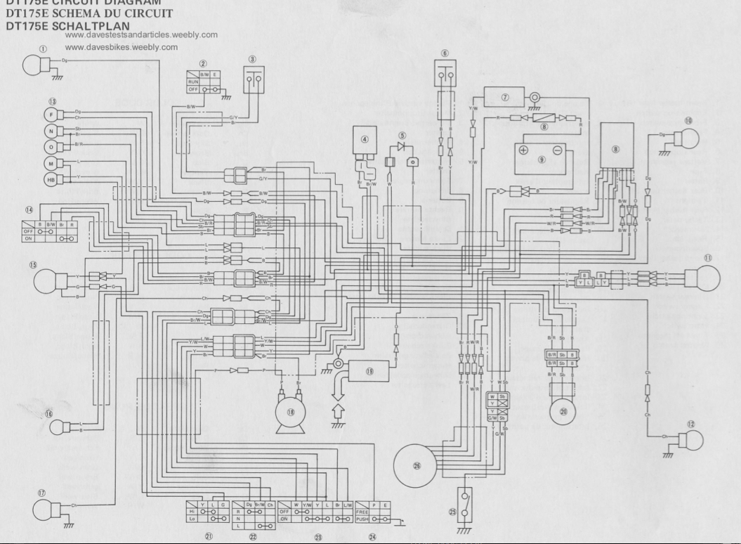

  15. So I finally found a wiring diagram on google, but none of the components are labelled. It looks like the CDI and stator that I have are definitely not for this bike. Potentially for a 79? Anyway, I guess that puts me in the terrible position of looking for electrical parts for this old machine. Any suggestions? Also, it looks like this diagram shows what could be a battery (#9)? I didn't know it had one. My wiring harness definitely doesn't have any battery connections.
  16. The biggest problem I'm having is that I don't even know where the stator would plug in to. There's a random red wire off my wiring harness, but it's not grouped with anything. The stator that goes with the CDI doesn't have a red wire, no.

  18. Wow Airhead that's amazing information! I knew there were some knowledgable people on here but that was next level. I have the 175E... does that fit in to either of those categories? It's got the round swing arm. Unfortunately, not only am I working with a box of random parts, half of the connectors have been amputated. The stator I'm working with is a 5 wire with no connector and the CDI is a 6 wire with no connector and no red wire. I'm starting to think these parts not belong on this wiring harness?
