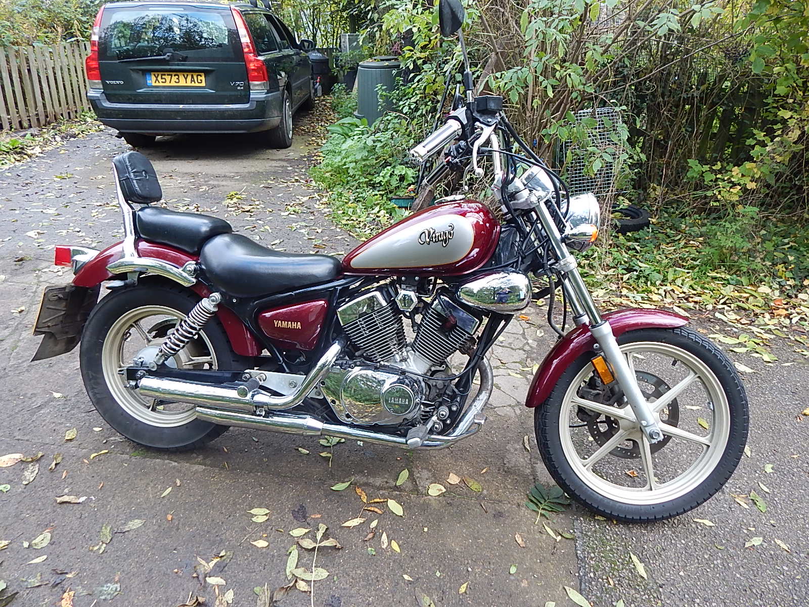

  13. sarandro posted a post in a topic in Yamaha Gallery
    Here is Ruby, very naughty as her electrics are in a big mess. She got me to the Farmyard Party two weeks ago but then blew all the fuses,,,currently trying to fix her with help of trusty husband and all the good people here at YOC
