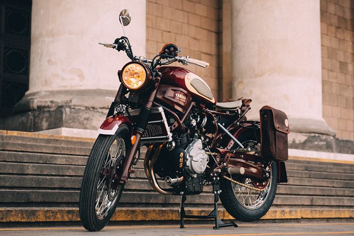

  1. https://www.facebook.com/yamahapolandposition/ Hi, It's Greg here, I work as a Yamaha sales specialist at POLand POSITION (#1 Yamaha dealer in Poland, East-Central Europe). Currently riding an XSR900 and just lovin' it! Together with my friend mechanic we have built a special bike, based on the XSR700. So here's the official story: "POLand POSITION's Pawel Rybak and Greg Dabrowski, the men behind this Yard Built project, have asked themselves a tricky questions... As a result we pay a sincere tribute to a first ever Yamaha motorcycle: YA-1, called "Akatombo" (Red Dragonfly in Japanese), first released in 1955. Built in only 26 evenings, with all mods done inside the dealership. YZ426 / Virago 1100 wheel combo - front and rear 19", Road Star handlebar risers, YZF-R1 master cylinder. Vintage replica parts: muffler, air filters, seat, fenders, rear rack, chain guard, handlebar, brake pedal, footpegs, fuel tank (stock XSR700 element underneath), grips, levers, switch controls... LED taillight + integrated blinkers. Original 1955 local plates with a valid numbers." What's most important: this project is for the European Dealer Contest - Yamaha Yard Built competition, ending on March 31st... Please be so kind to spend a minute and after reading this post: -visit www.yamaha-yardbuilt.com -find our XSR700 Akatombo POLand POSITION custom bike -click on the main picture -click the magic "LIKE" button And if you would ever travel to Poland or any other country in Europe and have some issues with the bike - just let me know and we'll sort it out. I really appreciate your votes, thanks a lot!
