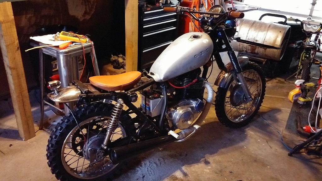

  3. As promised here is a picture of my ALMOST complete sr250. I still need to repair and paint the gas tank, button up the last few solder connections for the taillight, and install the headlight and LED flasher relay and install side mirrors. Hope you guys like it.
