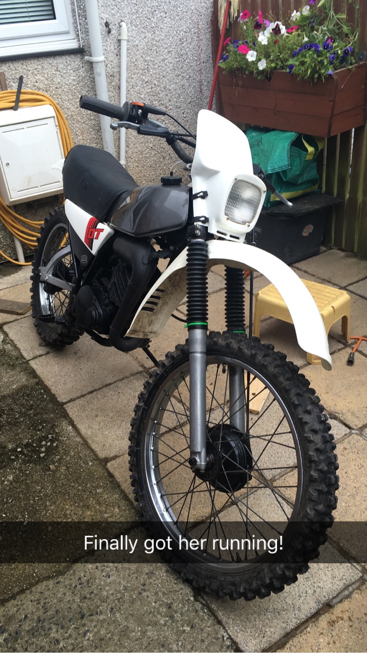

  23. Hello I need some help with my bike I brought a replacement cdi (one from eBay) a while ago and managed to get it started but the bike got really hot really quick also sound really tapping top end I also noticed the carb was leaking fuel out the over flow so I rebuilt the carb got it ultra sonic cleaned and checked reeds. since I have done this it's nearly impossible to start only starts from cold being bumped but when hot will start 1 or 2 kicks done a compression test around 145 -150 so that's fine when it was running I sprayed carb cleaning on crank seal no change. i don't think it's fuel related because I sprayed easy start straight into the cyclinder when cold kicked and kick and not even a slight sign it was going to start so I have the right stator? Someone has told me it could be wrong? Also my cdi only has 6 wires coming from it? Is this right and the last thing I know I've gone on abit! My stator was bolted on with the slot all the way to one side could this be the cause of impossible starting? And help will be appreciated
  24. Done what you said both plugs where wet, put the plugs back in started first kick and was running on both cylinders not sure why maybe float was stuck ohwell fixed now!! Thanks for help
