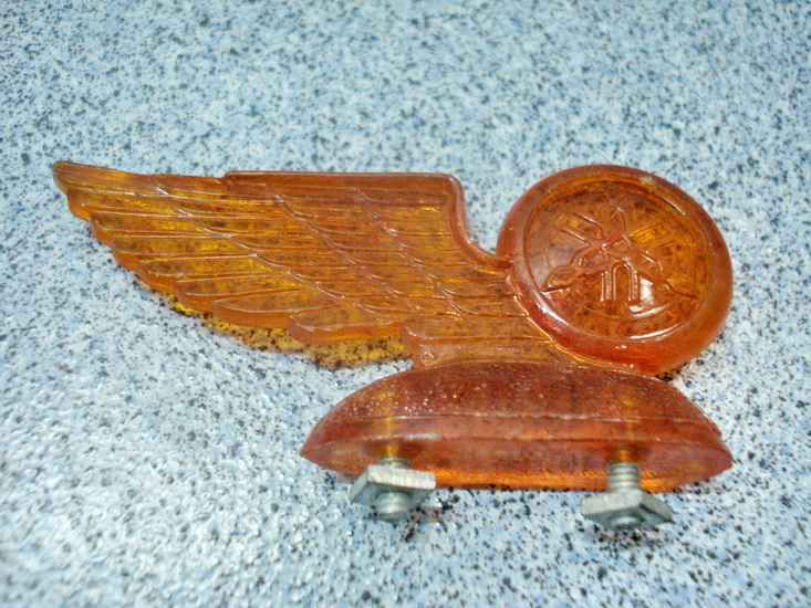

  5. i was told this is a headlight visor emblem. three holes, two for mounting and one larger for light so it would glow. was it a option, or aftermarket? does any one know what years and what bikes it was on?
