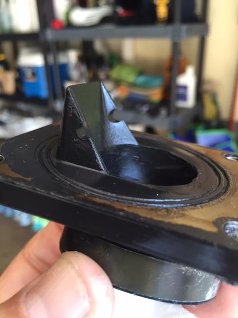

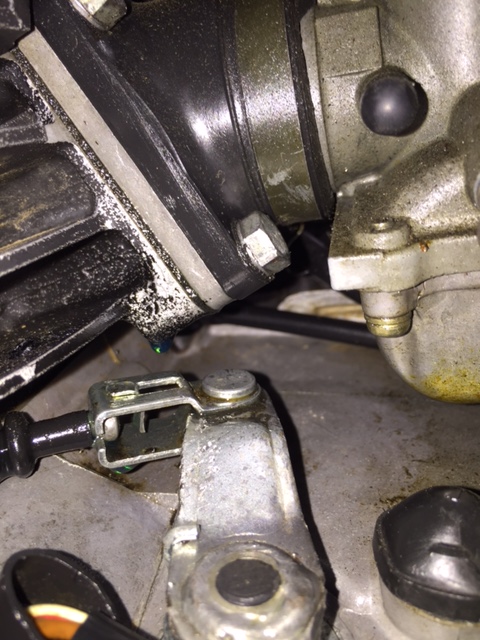

Haha nice to hear from you Airhead! Now you mention it I remember you told me about the O-ring a couple of years back... Mine looks as flat as a pancake. My gasket looks fine. Just went ahead and ordered a new rubber reed block manifold. Expensive little devil! As always thanks for the help and advice. The 'Atlanta Fettler'. -

I have had the carb apart so many times I have lost count... I believe the staining is from years past... -

I have a 2 stroke oil leak coming from what looks like the reed block gasket (you can see a drop of oil on the bottom of the cylinder and one on the clutch arm). Does anybody know what's going on here? Do I simply need to replace the reed gasket or could there be a problem with the oil pump? Thanks,
