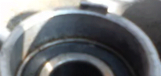

  5. Hi all Well i got back from a day at my parents earlier than i thought with an hour of daylight to spare so i whipped my front wheel off. i drilled the rim of the hub with a 1.9mm bit and knocked in a 2mm roll pin leaving in about 2mm proud and jobs a good'un. speedo works perfectly. thanks everybody for there help!!! and a big thank you to paul (airhead) for offering to come round and help. cheers all nigel

  11. hi there the proper part is a new hub/wheel and even second hand your talking a £100 hence looking for advice on a repair cheers nigel

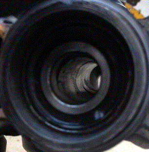

  13. Hi all i need some advice!!! I have discovered the cause of my speedo being intermittent. On the DT125X there is a single lug on the hub to drive the speedo gear and guess what mine is missing. i have been getting some movement due to the speedo drive gear rubbing against the hub as the tabs on the drive gear look a little worn. first pic is my hub no lug second pic is how it should be my question is do you think it would be possable to drill the hub and insert a pin. the pin would only be driving the speedo gear so should not be under a lot of strain. any ideas would be great thanks nigel

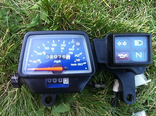

  18. Hi all has anyone tried to repair this type of speedo? the cable seems fine the drive is working. The needle is not moving and the milage is not moving, any ideas would be gratefully received cheers nigel
