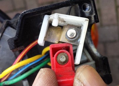

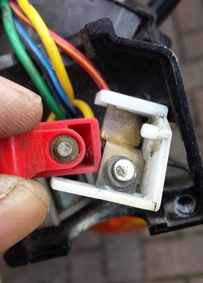

Thanks for the link to the part. A useful site for spares. The switch works perfectly, it is just sometimes it is it is not pushed enough by the "paddle". Clive The straightforward ideas are the best. I will try this. Ta.

Hi For some reason I was checking the brake light on my XJ6 and I noticed the brake light was on. I have worked out the cause is the hand brake lever. At one end of the hand brake lever is a "paddle" that when the lever is not held (i.e. the brake is not activated) the paddle pushes a little switch (see attached pictures ). I guess this is a very common set up (see attached link to photos). When the switch is pushed by the paddle the brake light is off. When I pull on the brake level the paddle comes away and the switch springs open and the rear brake light comes on. The problem is sometimes the paddle does not press the switch enough to switch off the brake light. I can overcome this by "flicking" the brake lever with my fingers, but it is tricky and I shouldn't really do this while riding. Now, over a year ago I was knocked off the bike by white van man and one bit of damage to the bike was a little cover that was part of the brake cylinder (?) arrangement that covered the "plunger" into the master brake cylinder (?) had sheared off. You can see this in one of the photos "brake lever cover sheared" Now, is it possible the "paddle" is slightly bent and with a bit of heat and bending I can get the paddle to push on to the switch when I release the brake lever? Regards, Clive

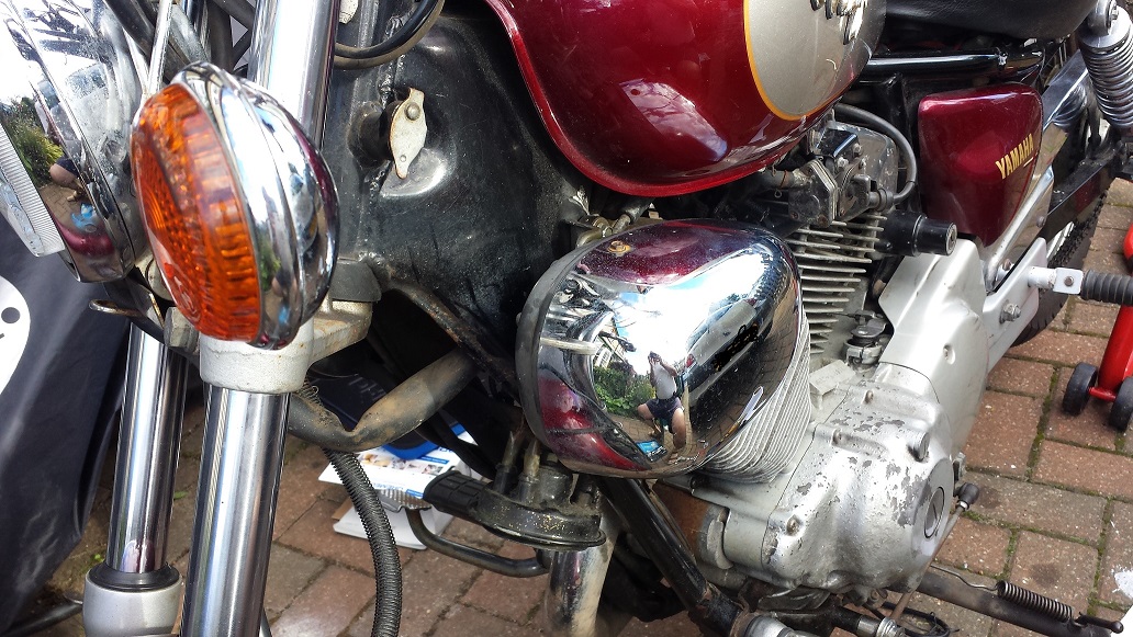

Another forum claims the pod contains a "Carburetor heater". I'm still intrigued what the liquid was in the frame that started to flow out when I undid one of the screws holding the left pod in place. I won't be fiddling with that again. Clive

Yep, I have the 300-odd page service manual and I can't find a reference to this object, but then "right-hand pod" isn't very descriptive and the file isn't searchable. Clive

I'll own up. I tried to take off the right hand "pod". When I remove the lower bolt, dark oily liquid flowed out. Recovering from my surprise I quickly decided it would be a good idea to put the bolt back in. I thought "oil?" but why oil in the frame? I thought "brake fluid?" then "shit!", again why brake fluid in the frame? When I mopped up the fluid on the driveway it looked to me like old engine oil - maybe it was. ?? !! Certainly not dusty enough for fairies.

Hi, Out of interest, when you look at the front of the bike, the left hand "pod" above the cylinder and below the fuel tank contains the air filter. What does the similar looking right-hand side "pod" contain? Thanks, Clive
