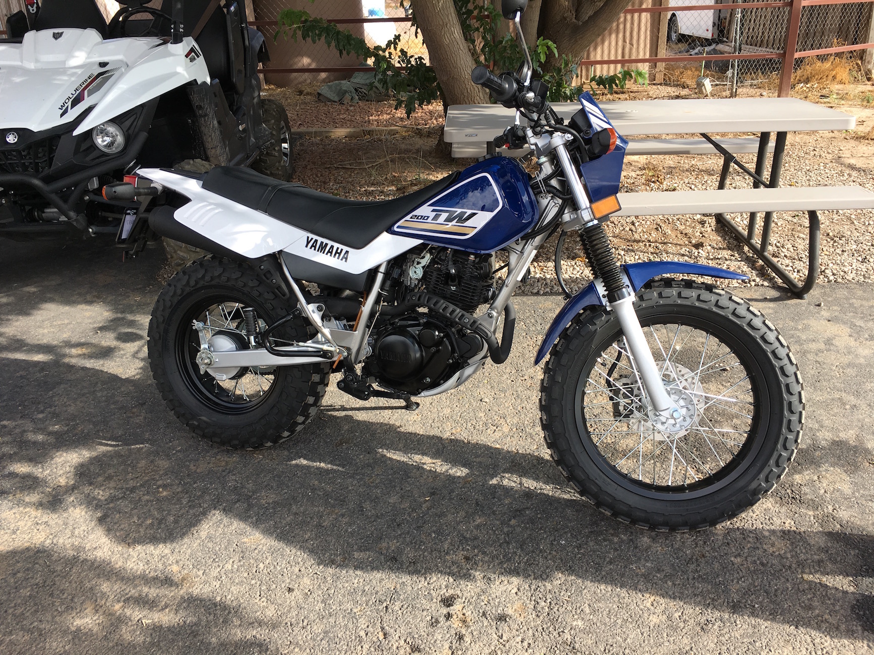

  5. I swear it wasn't me!! Never had a good look at it though. Guess I should look at the front wheel... Some ancient history: I went to what we call in the states a junkyard, specifically a motorcycle yard, back around 1997 or 98, as near as I can figure, in search of a project bike. I had been out of touch with scoots for quite a few years, but something gave me the bug and I went looking. I found two 1978 DT175 basket cases in this yard and picked them both up for $125 US. It took quite a few years to get it sorted to one rideable bike, with copious support from a then-budding ebay. About the only thing original from that rust-infested junkyard is the frame and engine. I'm pretty sure the wheels both came from ebay, and they just got bolted on. I think. Lots of water under the bridge of my memory, and I can't find the pics I'm sure I took as I went along. Pre-digital camera days, so not on my computer. So waiting on parts, the true sign of an avid Yamaboy. At least I have the TW200 to ride whilst I wait. It's a fun little thing, for something with valves, that is. I have 32 miles on it so far; I've been sorting the jetting on it with the help of peeps on its eponymous forum.
