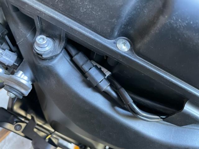

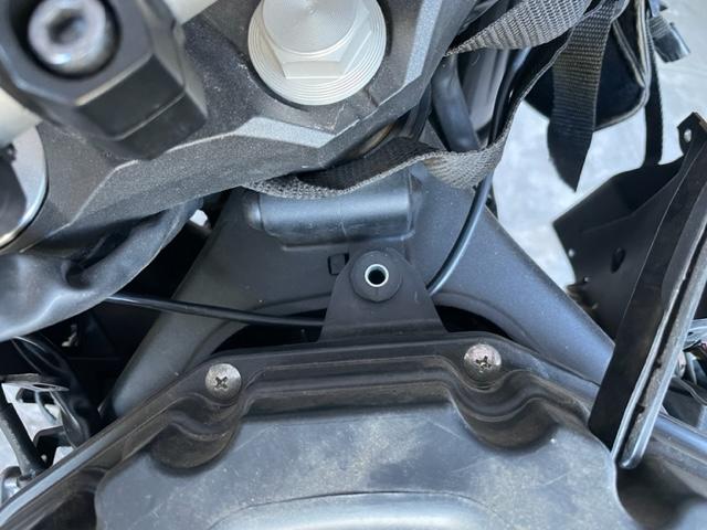

Newer Yamaha MT09s, like mine, come pre-wired for heated grips. Yet, you'll still need a harness adapter unless you're a rebel like me, and decide to wire them directly to the battery. This does mean saying a brief 'hello' to your fuel tank though, as it has to be removed for direct installation. For easier access, you can connect just behind the left side panel if you opt for the harness adapter. Do remember to tuck your wires snugly under the airbox top bolt, making sure they're not squished like a pancake.
