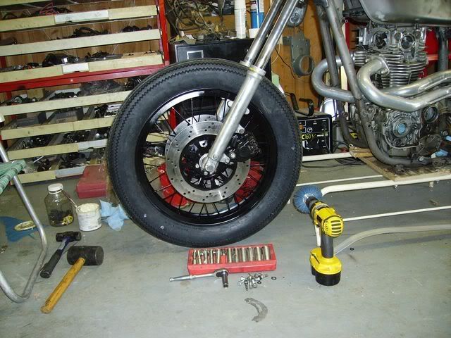

not familiar with european xs's models, is it cast wheel or spoke, if spoke is it aluminum or chrome? try to loosen the axle then check fit, then tighten, see if you need a shim on axle or shim on caliper, I put them on my 78 cast wheel and on a 76 im working on now with spokes, the spoke wheel I had to use xs 11 rotors which had a smaller dish.

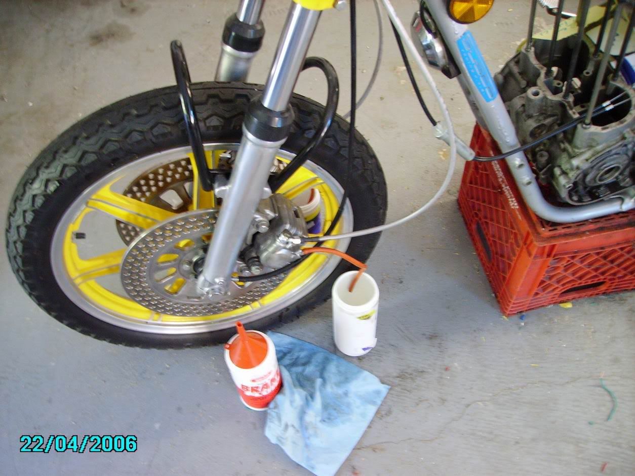

and OH man wait till you bleed em , there a buger to bleed! .

when I changed to twin disks on my 400 the cast wheels where fine, but when i had spokes put on I had to shave a few mill off the caliper mount.

hey when you did yours, did you use the 76 rotor? I tried mine with two 76 model rotors and then two 78 rotors then finally the xs 11 rotors which required no shimms. the first two option were way off. Are the 76 rotors the deep dish on the euro models? thanks.
