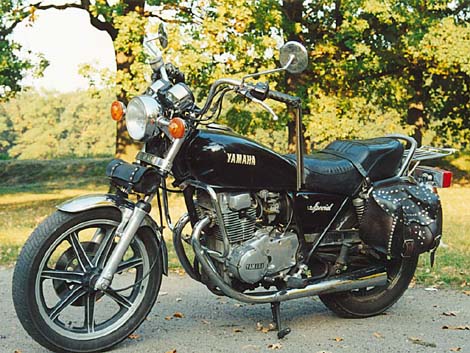

So, are we correct to assume that your alleged Maxim actually looks something like this? :unsure: .....
SOHC model that's actually a Special :rolleyes:
