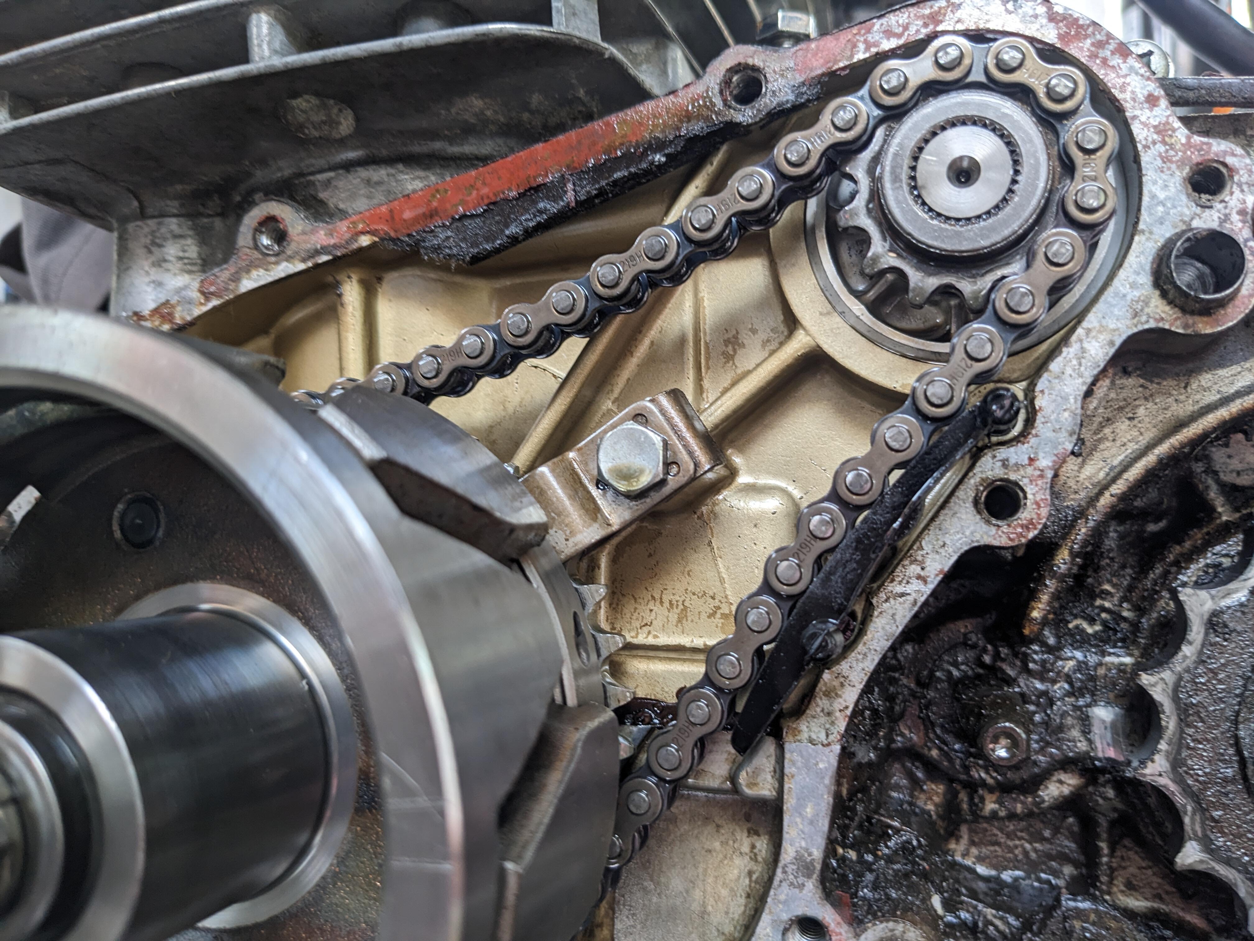

Morning.
The starter motor was not engaging properly so I have taken the alternator cover off for a look see.
There apears to me mucho slack in the starter chain, is this normal?
I have about 15mm of slack? :(
Or shall I just do away with the electric starter altogether.
Is it actually adjustable? I'm not sure if it will make much difference.
My eyes ARE however drawn to your primary drive. That's a LOT of wear. You need a new drive chain (primary, chain, secondary)..!
Yeah It's a job to be done when the engine is back in the bike.

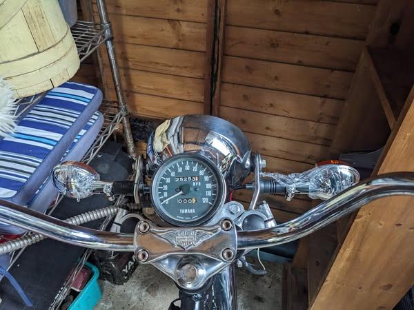

Replaced the front indicators this morning and sorted the speedo.
Now tackling the switch gear, kill button was not working and the starter button was missing.
Lucky I have loads of spares that came with the bikes.
Waiting for front caliper seal kits x two, then I can get the front brakes working.
Tony.

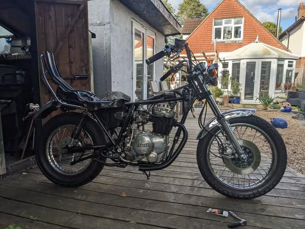

Right, it's time to get back to work.
Engine is back in.
Wiring, carbs, exhausts,chain, claen and polish to go.
Slowly getting the heap back together.
Want to refoam and cover the seat to try and slim it down a touch.
Would also like to lower the rear end a touch, that huge gap between the tyre and the mudguard...yuk.
Looking good...
I'm not sure I'd lower the back end. It's that height for a reason.
Before lowering it, see if you can find a way to 'hide' the gap...
Maybe some custom textile/leather paniers?
On 29/08/2025 at 20:09, AMB said:
Morning.
The slack should be between 5-7mm, looks like you need a new chain and sprockets for the starter. It's probably rattling already, and may risk jumping which could crack the housing.
