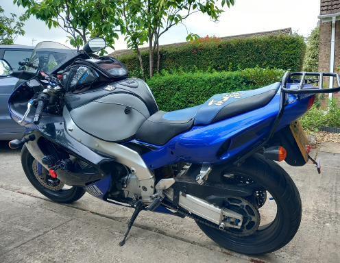

This is my thunderace, I don't have to worry too much about cleaning the engine as it is largely hidden lol.
I'd think any deep cleaning with aluminium as the subject is rather a dodgy business, I'd try Youtube on that as alloys in general can be damaged fairly easily
