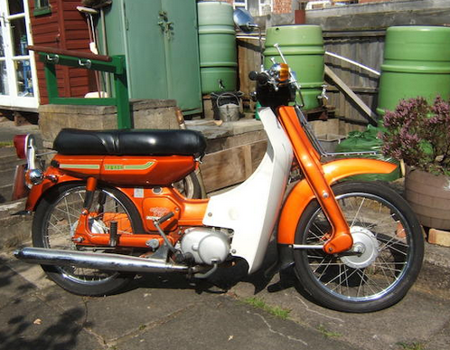

Welcome in Meatballs......Ah the V75A..the Ol Yamaha Step-thru, haven't seen one of those in ages!!..image.png
