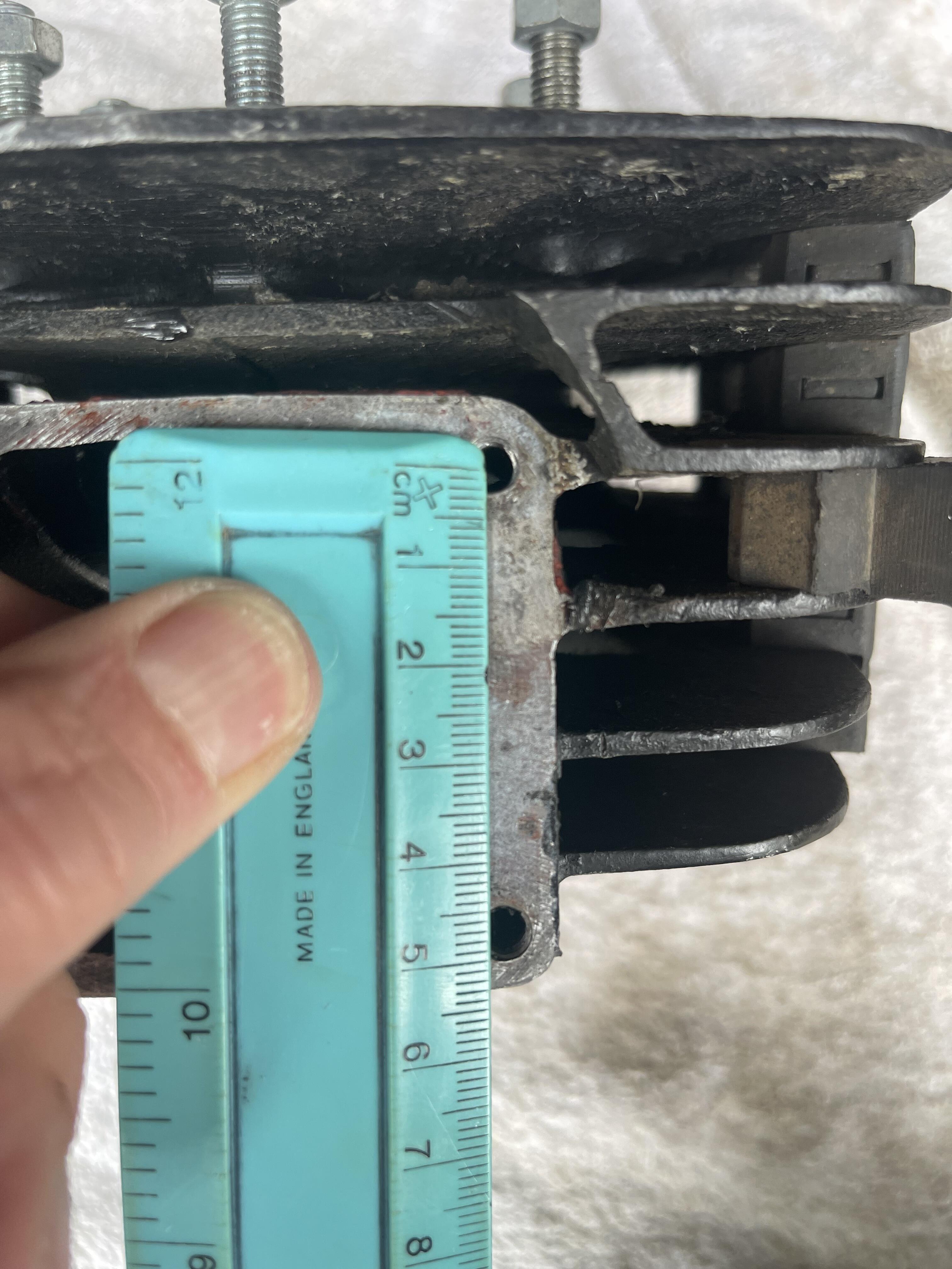

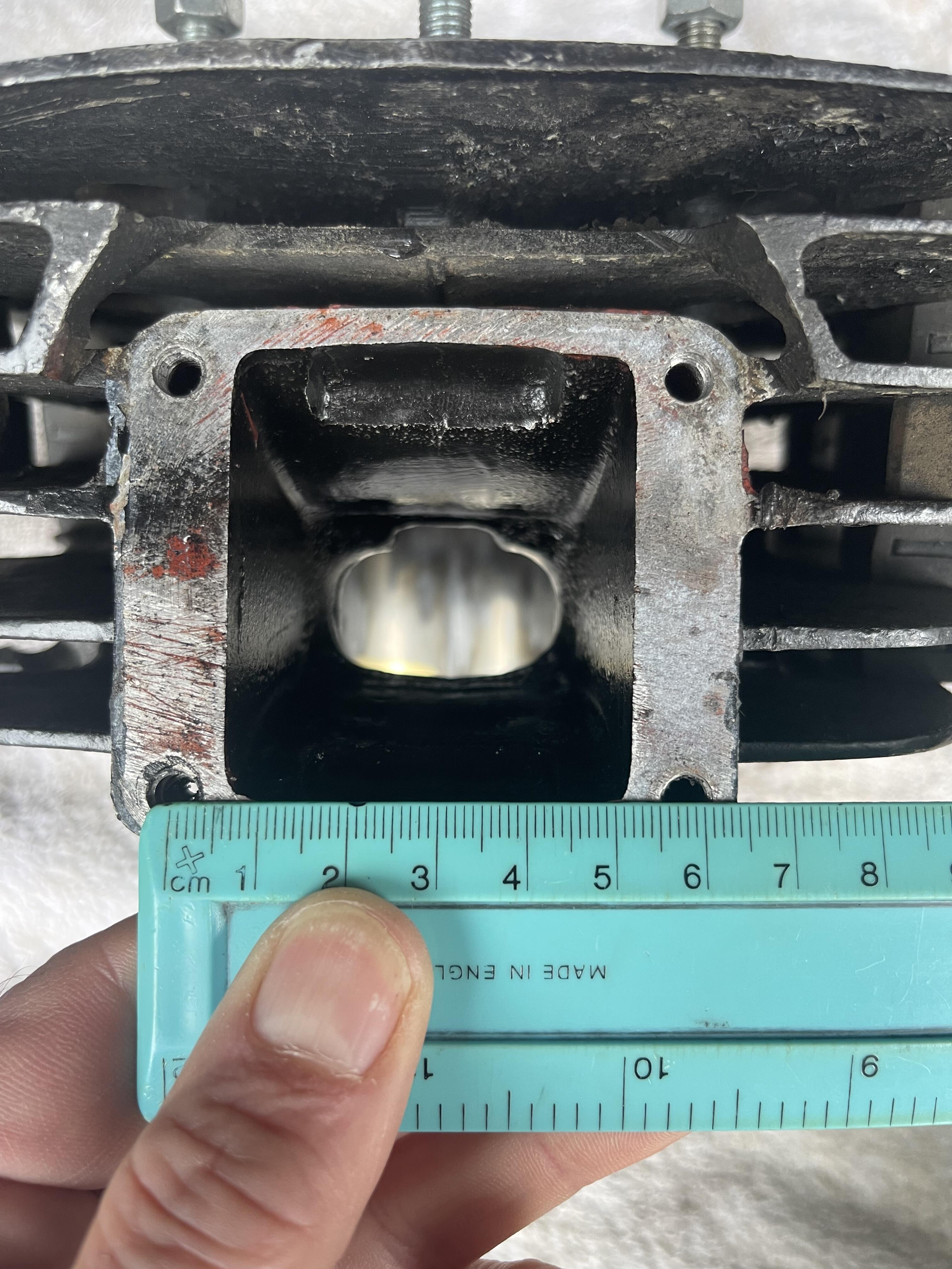

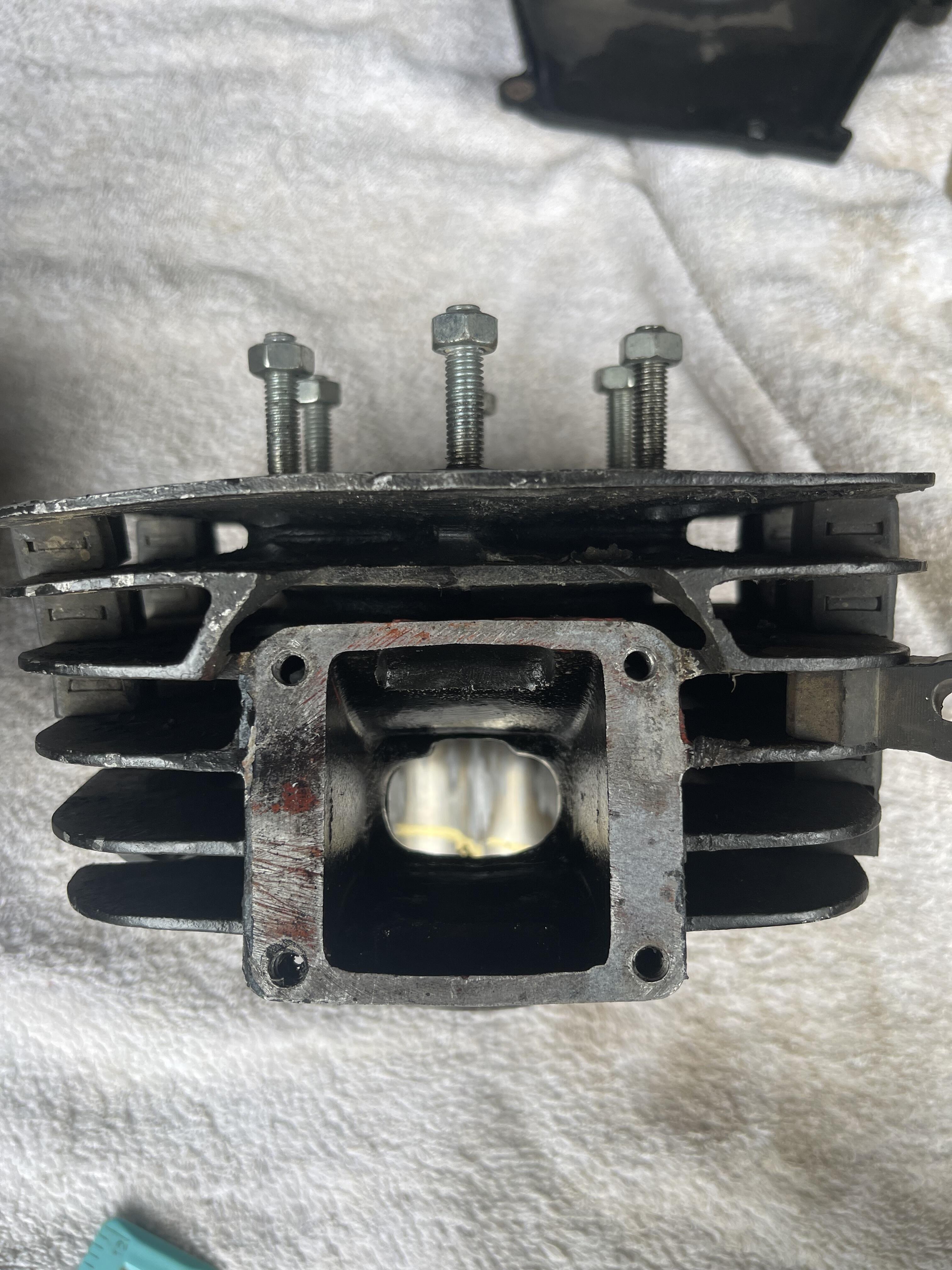

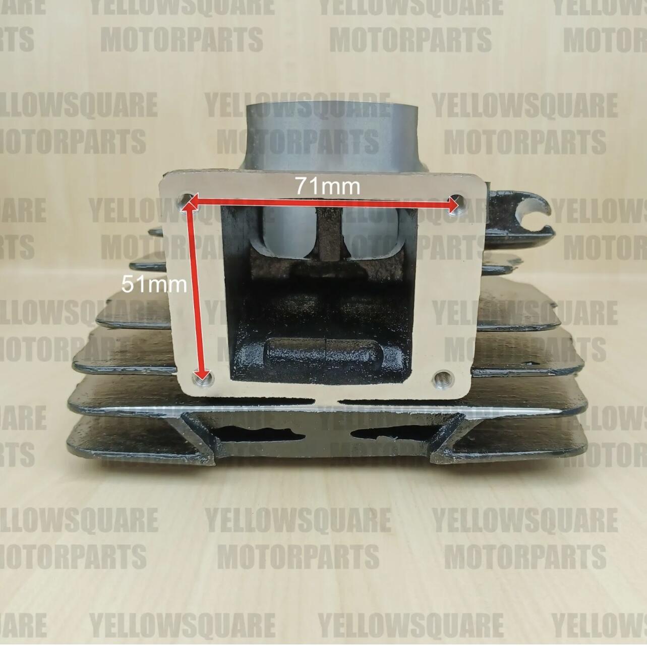

Looking for a little help as I’m totally stumped. DT MX 175. Top end rebuild. A modern replacement has an inlet port stud spacing of 71mm x 51mm. The part info says it will fit a 1981 - w reg.
The actual one on the bike that needs a rebuild is about 57mm  x 47mm
The engine number code is 2k4 denoting 1979-1982 so the part should fit but it won’t.
The new has a twin inlet and the original has a single inlet.
1st pick is the new part, others are the old.

As regards to your DT cylinder , is this a Psychic one? which i think means you need their 70mm race carb to go with it as it's not compatible with the OEM carb.

Apologies and thank you. I’ve seen the Psych ones on eBay as well. These are twin port as apposed to the single port that we have, and they seem to make it clear that it won’t fit ours Also the studs for the reed is quite a lot larger than what we have. In an ideal world we’re trying to keep it as true to period as we can, so I guess I’m hunting for a needle in a haystack and hoping that someone out there as one from this period.
