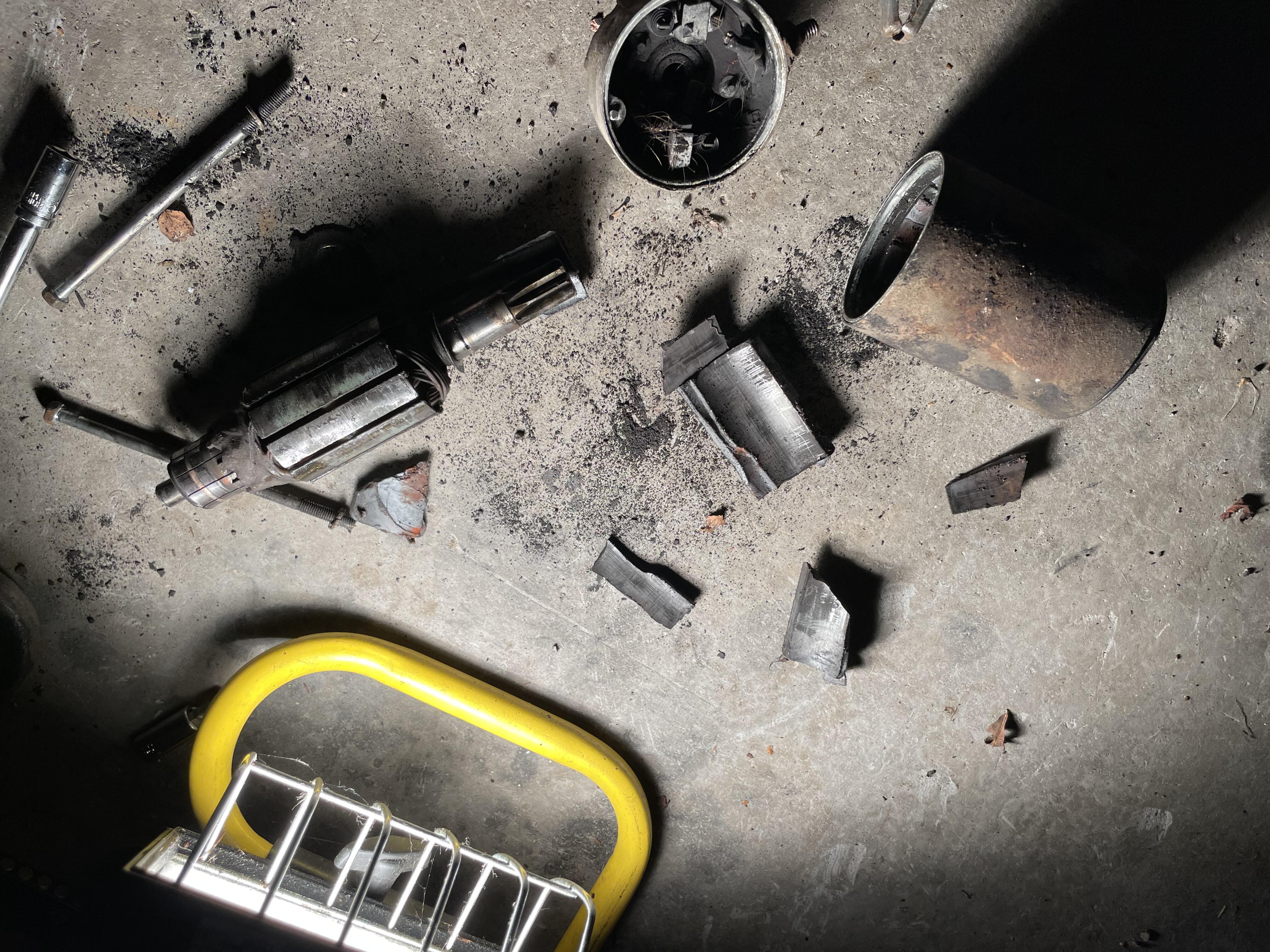

SR125 Starter Motor
The magnets, or the bushes???
Very much the magnets!
Sorted with a replacement from a later model by midday today , fitted and works by the evening. Power of the interweb Need it to start for MOT, have passed my big boy license so will be selling soon 😀

If it is of help to others the starter from earlier and later model whilst visually different are a direct replacement
