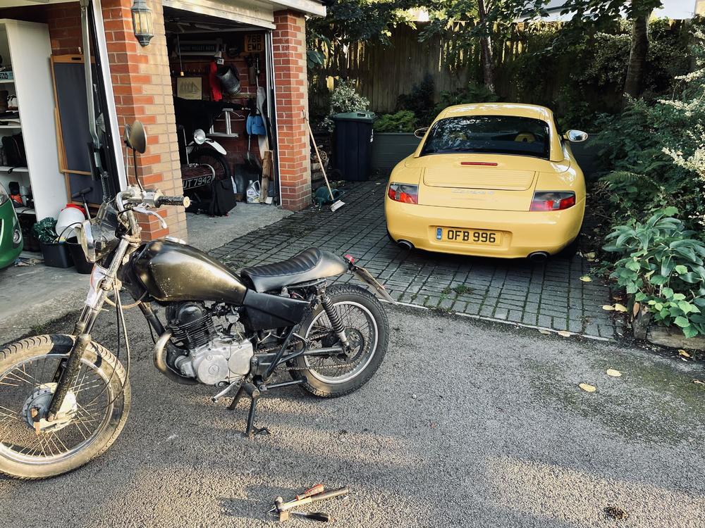

Riding for about a year, owner of a fairly rough 1991 model and enjoying the trials of running a 30 year old small bike 😀
Yeah, that does look a little rough! And possibly like it's frame has been modified! lol.
I like that you're apparently fixing some of it with a hammer though... :D
If you can’t fix it with a hammer then it must be electrical!
yes, previous owner did rather a hacksaw job on the frame, I can see what he was aiming for but craftsman he was not!
