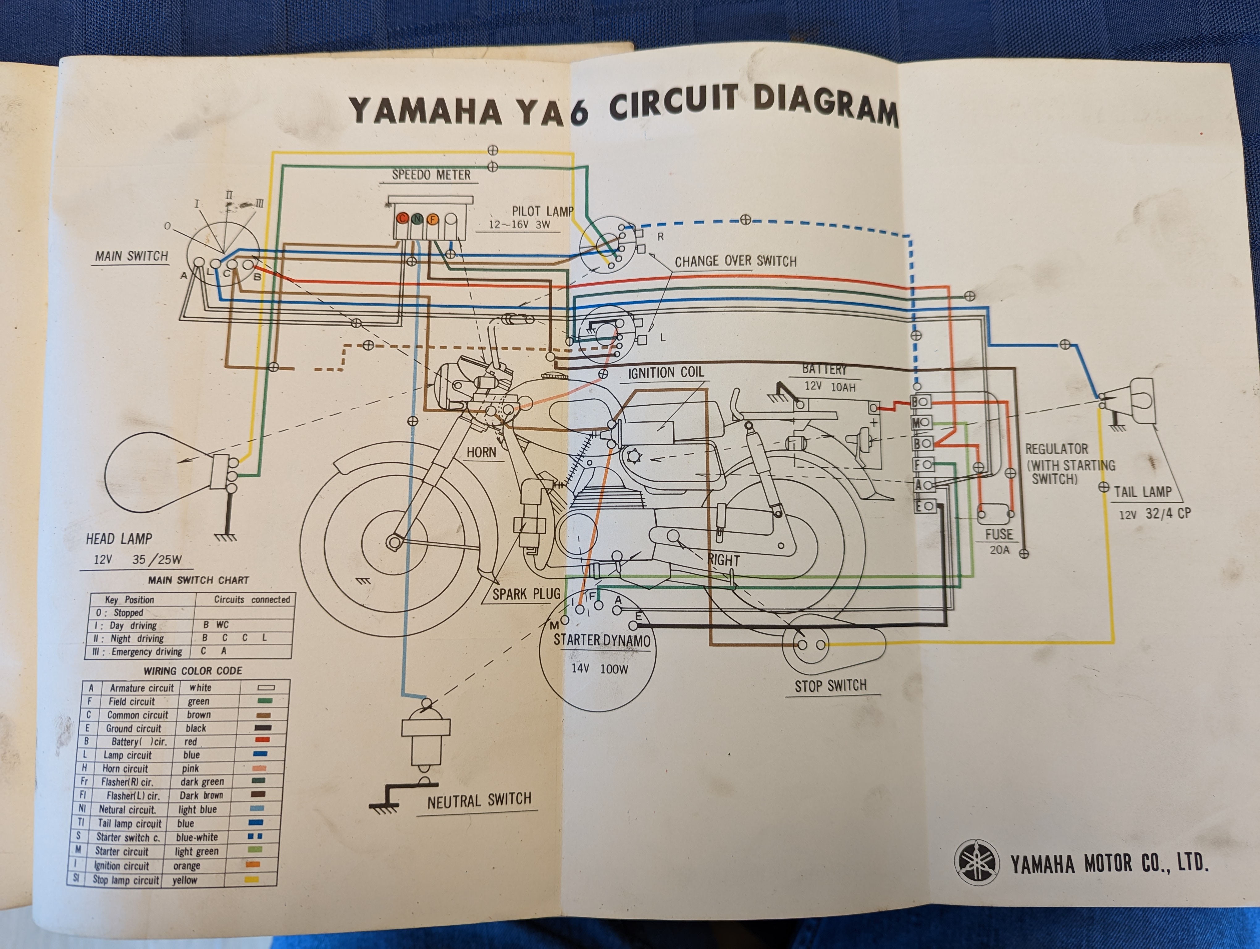

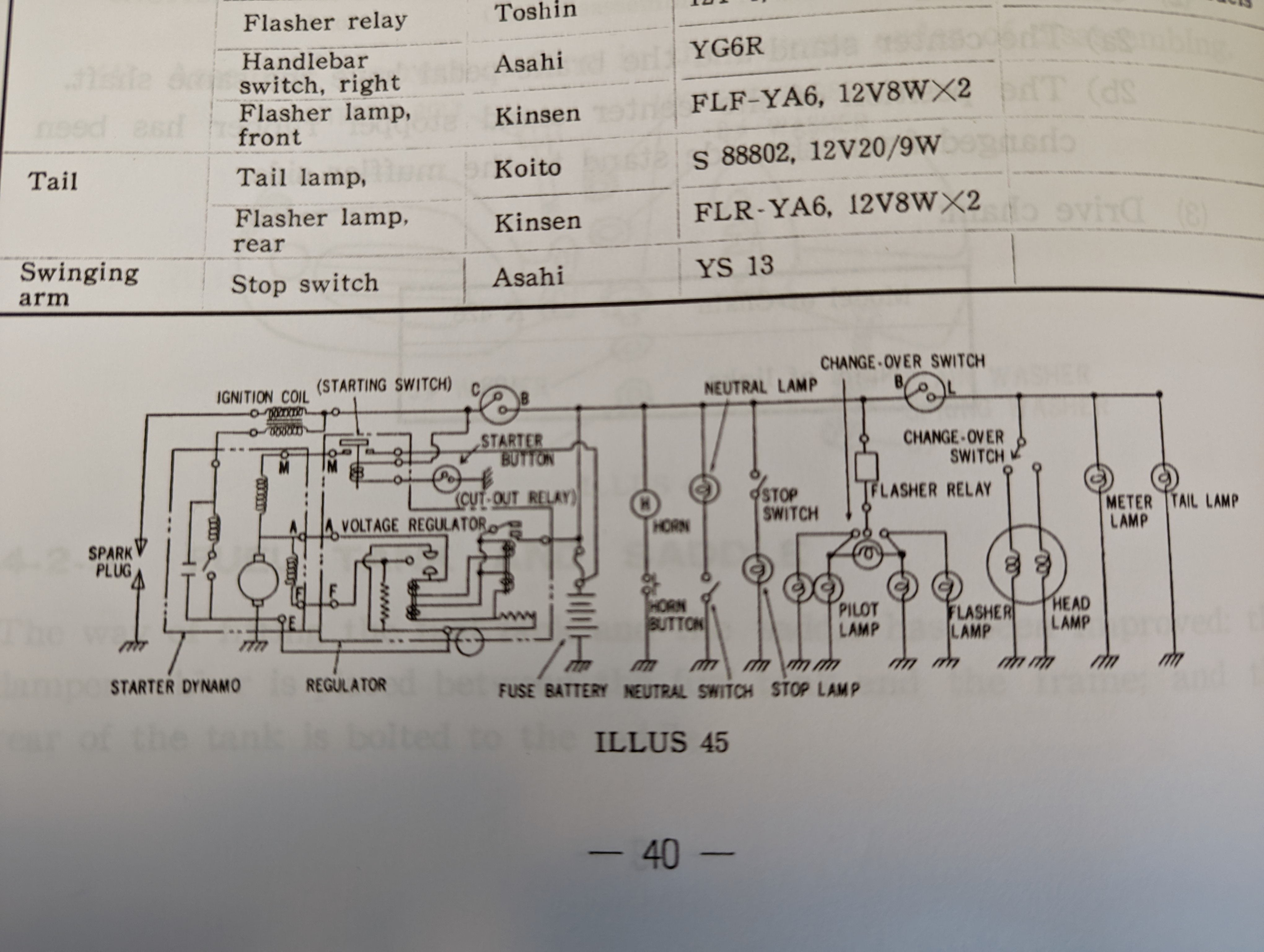

I have an update. I tested the starter button with a circuit tester from the battery and the button (circuit) works. I then jumped the starter directly from the battery to starter (M circuit) and it cranked over, but no spark at the points or spark plug. I then jumped the battery circuit (B) and the common circuit (C) at the ignition switch and the starter button would not work. It almost seems the starting switch within the regulator is not engaging. As previously noted I have replaced the original regulator with a NOS one, but I guess that doesn't mean the starting switch works. Thank you again in advance for any advice / thoughts.
Thanks for the circuit diagram, that's certainly not an easy diagram to follow, they've come a long way with how there are presented today compared to 1964!!
Nonetheless, with a light bulb you can test quite a bit!
Firstly are you getting a voltage on the LT side of the coil ? (LT low tension)
The starter/dynamo has an orange wire going from it to the LT side of the coil, disconnect it at the coil and put a light bulb to earth, does it light up on turning the engine over?
Update. I think I have figured it out. After looking at the wiring schematic I thought the only thing that could be stopping it was cranking over / starting is the starting switch located in the voltage regulator. I took the regulator off, cleaned the contacts on the starting switch and reinstalled it. It worked, but no spark. I cleaned the contacts on the points and now I have spark. It wouldn't start, but I think that is a fuel issue. I am off to get some gas. I will update later. Thank you Neo for pointing me in the right direction.
