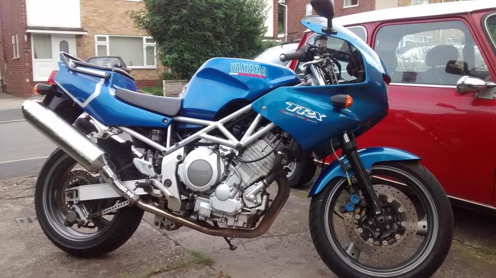

I have included a picture of the TRX, although it now has a black repaired fairing after a coming together with a pheasant at 90mph. The bike runs well but pops through the right exhaust once warm, I have checked the exhaust for leaks, Sorted the valve clearances, fixed a crack in the plastic cover on the side of the right hand carb and replaced vacuum pipes. Next is to change the carb inlet rubbers. Any other ideas would be welcome.

Have you checked the baffle hasn't fallen out? :D
:welcome: I have a '96 TDM with '99 carbs and they fitted different needles fir each carb.
I have a GPR can on the back and that pops, try opening up the pilot mix screw  to 3 turns out
