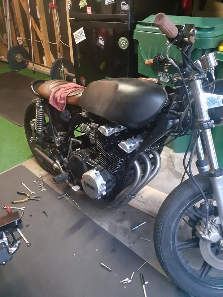

Hi guys! So I posted recently through my top end rebuild and I'm damn near done. I've run into some snags though and could use some help. I called all of my local shops, repair shops, muffler shops, restoration shops, and even some friends but I'm on my own. Shop were all full or not in "Vintage Season"... Anyways, let me start by listing what I have done and then where I need help! Thanks in advance!

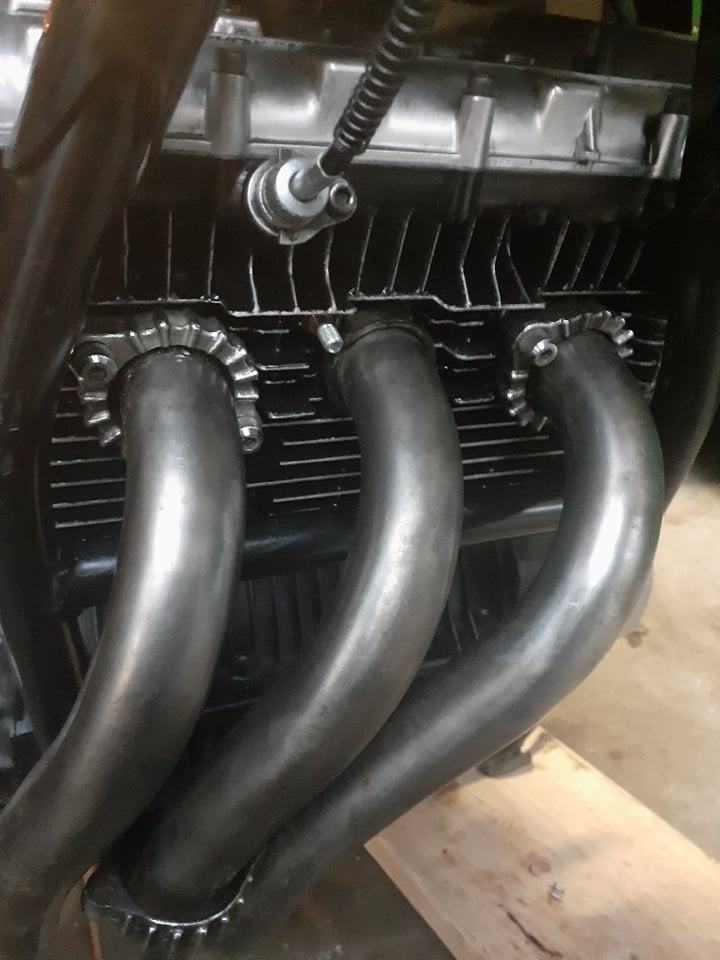

-Replaced exhaust studs and nuts. Honestly question that system of studs flanges nuts and retainers and how they efficiently do their job...but it was 77..we've come a long ways.
-Reinstalled exhaust.
-Clamped one loose muffler to the exhaust pipe. (PO had it hanging slipped on). Improved running sound.

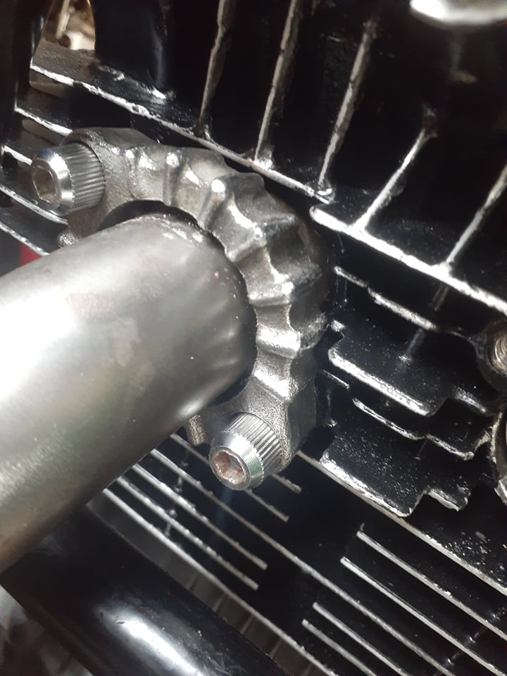

-Oil leak. At front left jug/head area...will include picture.

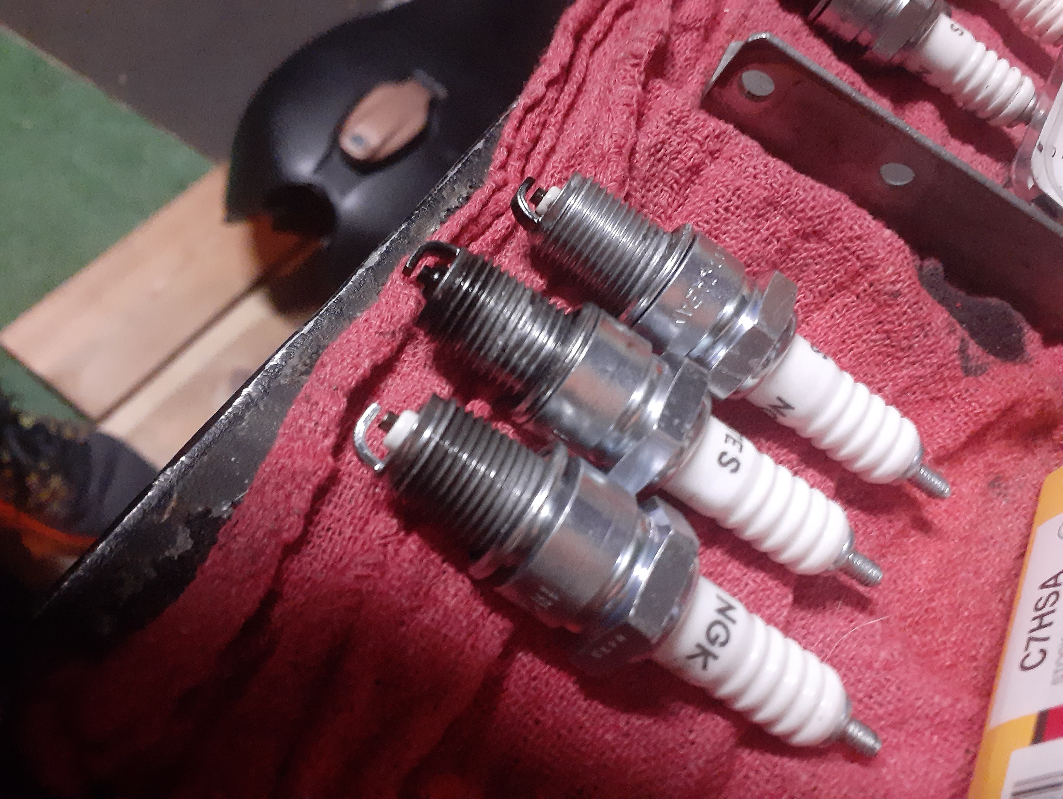

You've got one oily plug, was that before or after the rebuild?
That was before!
