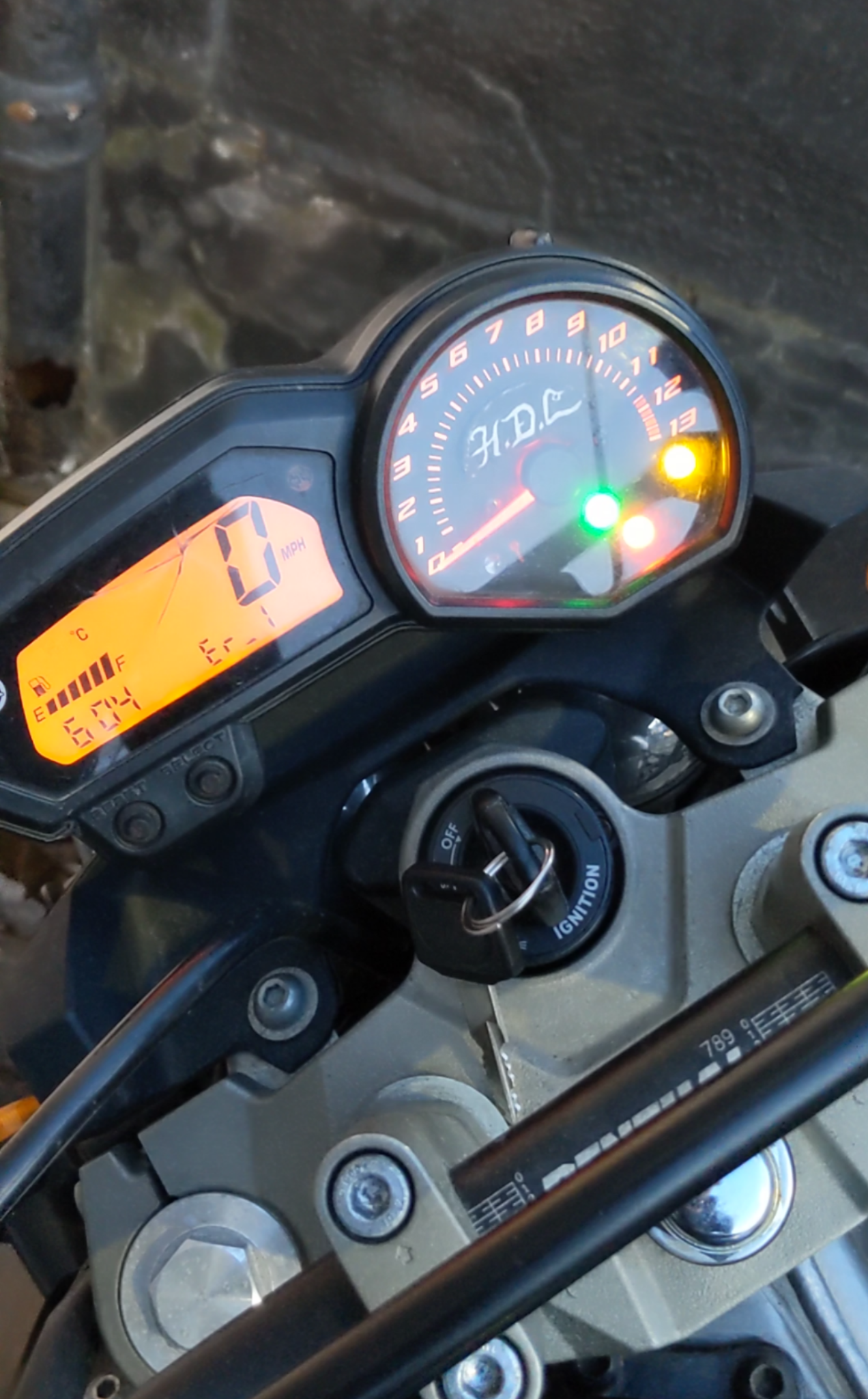

Hey everyone, just trouble shooting here. Bike (09 xj6n) has been working fine no issues at all and now this happens when I switch ignition on. Error code ER_1 and shows temperature and engine warning lights! The speedo doesn't change from 0 while riding aswell since this code has shown up. Anyone every had this?I've read it may be something to do with ecu. Where should I start?
Thanks in advance, any help would be great

Dash looks the same as my FZ6 S2. On mine, code ER-1 is "no communication or unreadable communication between ECU and instrument cluster - engine will not run". Causes are " faulty wiring or wiring connector - damaged instrument cluster - damaged ECU". As your instrument cluster appears to have several cracks in the screen, I suggest you start at the cluster.
