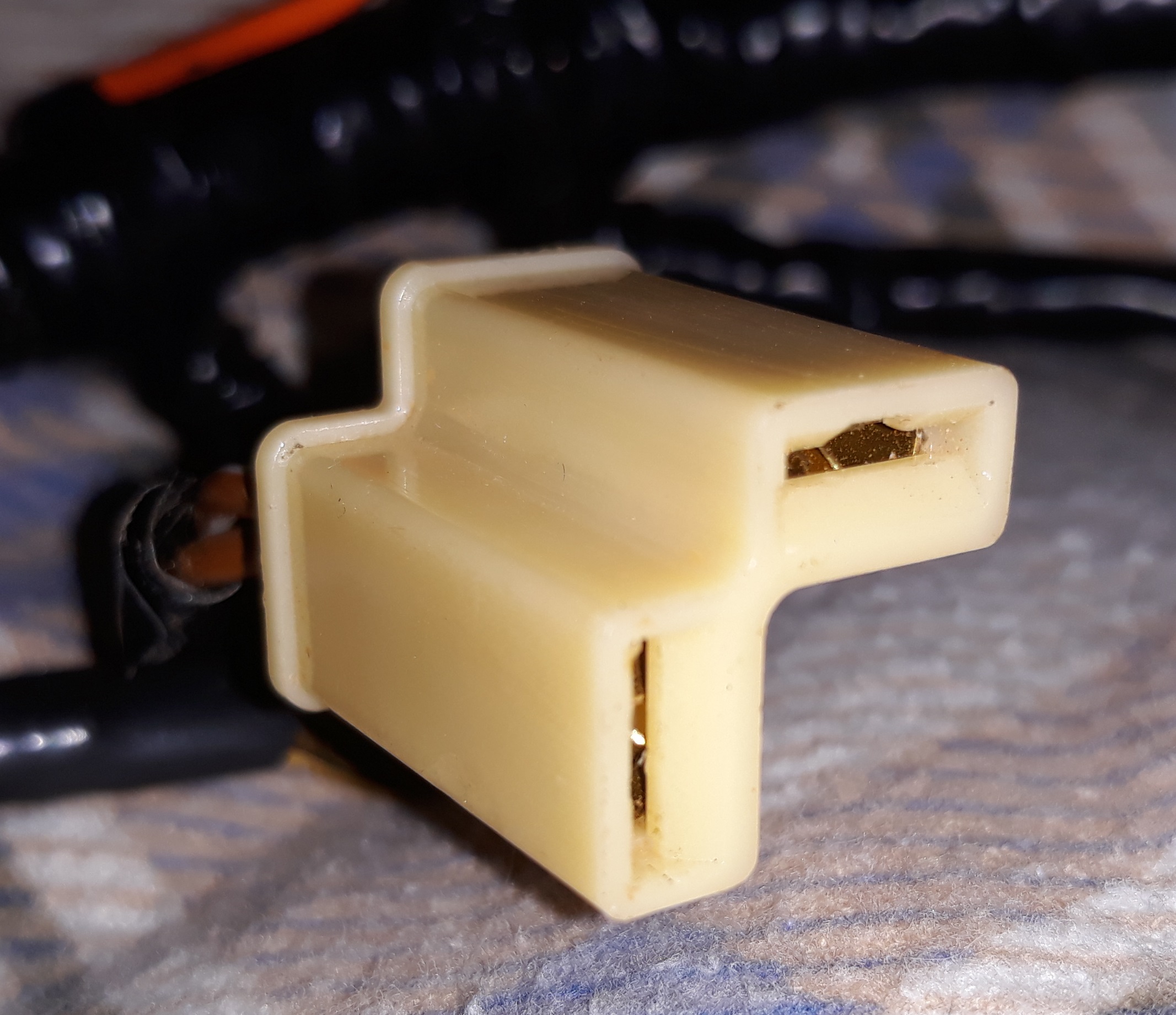

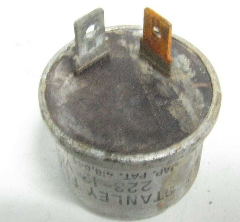

You should be looking at a flasher unit like the one in the picture with a plug like the other picture. According to a wiring diagram I've seen it's supposed to be on the left hand side near the ignition coil which will be right under the tank hanging off the frame (?)
I don't think i'm allowed to put up external links but if you search SR250 wiring diagram in google images it should show up.
Hope this is of some help. Somebody with more of an idea might be along soon... 🤓
As scott says ,  be under tank,  ,,  i just used   cheap  repro ones ,,Yam  N.O.S,,  are silly money,,,
