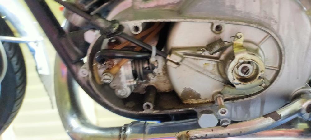

I have aYDS5 engine and when I took the clutch cover off oil was coming out of a screw hole is this normal  or something serious?
Which screw ?  the oil pump  banjo ?
Thanks for the reply but found that one of the screws was to long and broke through into the crankcase and was the engine oil pouring out
