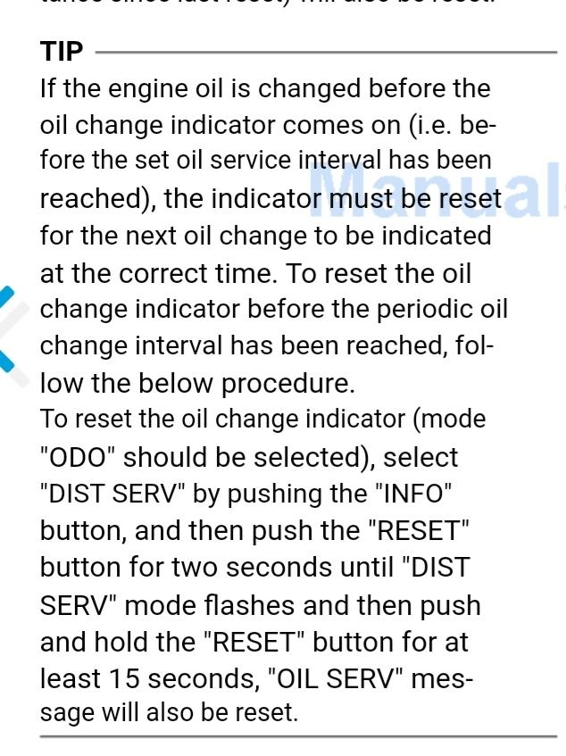

How don I reset the service light on my Yamaha mt 125?
I cant find anything on Google about it... Can anyone help?
I have seen that one. It is for the Oil reset and it is not the same, The “dist serv” doesn’t go away by doing that....
Try this
