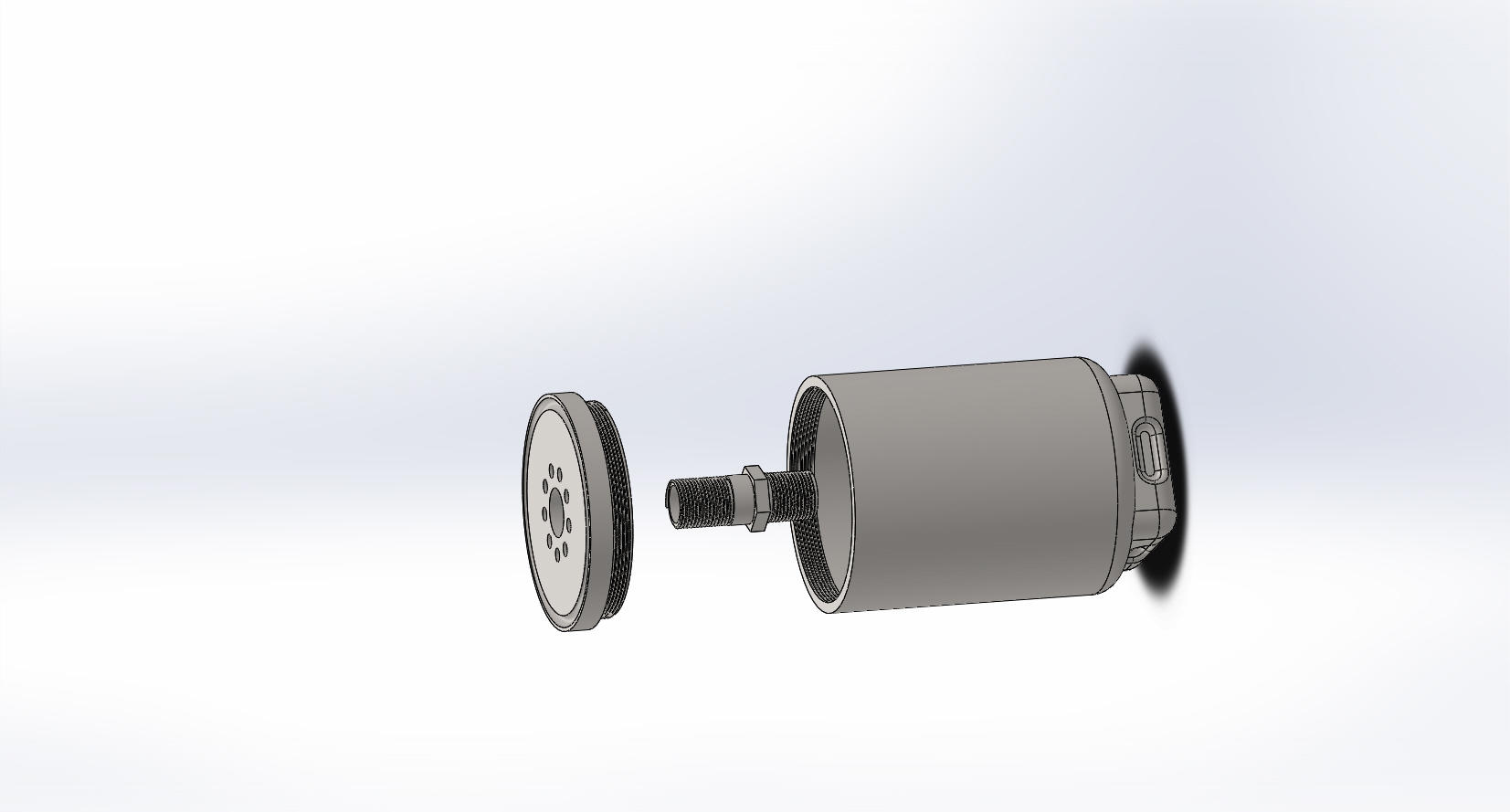

March 22, 20196 yr Author I found 4 of 10 so far and I believe Len from xj4ever has the other ones. The other 2 plastic sleeved ones are only available without the plastic. The head studs are M8x1.25 on both ends, so worse case scenario I can make some. The tensile strength of the threaded rod is 150kpsi, so I don't think it'll be too weak considering the holes have aluminum threads. I could use the rod as-is since all of the holes are a little larger than M8. The reason the shanks are cut narrower than the thread is to avoid contact galvanizing between the steel stud and the aluminum block and head. The center 4 studs are larger in the shank for more clamping force, which is why they sheath them. Working on a custom oil filter kit for the XJ. Spin-on adapter and decor cover. Tossing around design ideas for CNC/lathe ease as well as base plate and cover style. Here's the starting point.
March 22, 20196 yr Ok well done with the bolts, just keep looking you never know stranger things have happened, as to the oil filter spinner, I think that they do one for the FJ model, it's a 1100 or 1200 cc bike but pretty sure the oil filter and spinner are the same? I used one on my FJ and it really made it much easier to fit new ones. Found this on another site fj1200 oil filter conversion kit. Might not fit but surely worth a look!
March 22, 20196 yr Author Yes, there are spin-on adapters for the XJ series, but it's just a plate like that. You still see the ugly filter sticking out the front like a wart. I'm going to make mine with a decorative cover. Similar type of construction, flange to flange plate with an M20x1.5 pass-through retainer. I'll have a cap that attaches to that plate, just not sure on the design of the plate and cap yet.
March 23, 20196 yr Moderator I stuck a spin on filter adapter to the fz600 the filter is exposed but helps with cooling and need to be careful of clearing the downpipes
March 23, 20196 yr Author 3D printing a set to see how it fits. I think I may change up the hand grip, not really liking the square now.
