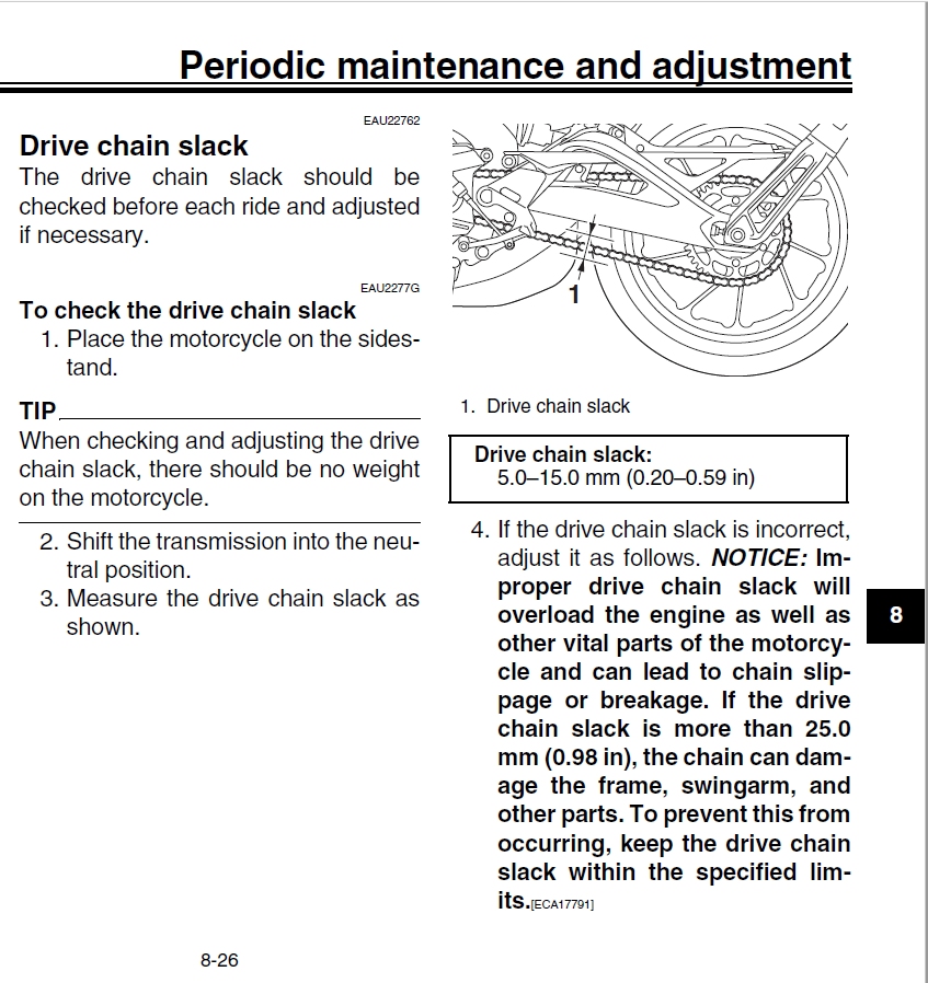

I adjusted the chain tension on the MT to the specs in the 2017 manual, 5-15mm. It was incredibly tight, I could hear the drive-train whining when I rid the bike, I've slacked it off to 25mm and I still think it needs more play.
I phoned three Yamaha dealers and they recommended between 15-35mm but no one actually knows what the exact tension Yamaha recommend is. The issue for me is that the bike is under warranty and the manual states frame damage may occur if play is over 25mm.
I've just sent a follow up email to Yamaha as they are saying the manual is correct.
Does anyone have a different year MT/FZ which states a different range?

Well I've just got a reply from the Customer Experience Coordinator at Yamaha:
Quote
I’ve checked with one of my colleagues and he has advised the following.
Have a friend sit on the bike when adjusting.  Adjust chain to you owner’s manual recommendation.
I've sent them a follow up as the manual clearly states that chain slack for the MT09 has to be done with no weight and their slack in the manual is far too tight.
I've asked them what will happen with warranty if the chain being too tight/too slack causing damage.
  • Admin
Yamaha are standing by their manual recommendation.
Quote
Hi Alex,
I have received the following advice from our motorcycle technical representative.  This information has been supplied to our dealer network and our NSW field service representative has given me the same advice.
We are unable to advise adjustment outside of the information contained within your owner’s manual.
The drive chain slack specification (5-15mm) has been the same since 2014 model MT09. This has not resulted in any damage to the transmission.
If concerned about the tension on the drive chain, you could maintain the upper limit 15mm. Please note the chain in excess of 25mm can cause damage to frame and swingarm.
Secondly, you can recheck chain slack with the ride on the bike and maintain measurement.
Refer to attached handbook extract.

Yeah I'd normally follow the manufacturer's guidelines, they know best and have spent millions on getting it right. However when you can hear the drive-train whining it doesn't make you feel that they are right on this one.
I know they are different bikes and frames, but when you look at the MT07 and MT10 the MT09 really sticks out.
MT07
Drive chain slack: 51.0–56.0 mm (2.01–2.20 in)
NOTICE: Improper drive chain slack will overload the engine as well as other vital parts of the motorcycle and can lead to chain slippage or breakage. If the drive chain slack is more than 58.0 mm (2.28 in), the chain can damage the frame, swing-arm, and other parts. To prevent this from occurring, keep the drive chain slack within the specified limits,
MT09
Drive chain slack: 5.0–15.0 mm (0.20–0.59 in)
NOTICE: Improper drive chain slack will over-load the engine as well as other vital parts of the motorcycle and can lead to chain slippage or breakage. If the drive chain slack is more than 25.0 mm (0.98 in), the chain can damage the frame, swingarm, and other parts. To prevent this from occurring, keep the drive chain slack within the specified limits.
MT10
Drive chain slack: 20.0–30.0 mm (0.79–1.18 in)
NOTICE: Improper drive chain slack will overload the engine as well as other vital parts of the motorcycle and can lead to chain slip-page or breakage. To prevent this from occurring, keep the drive chain slack within the specified limits.
