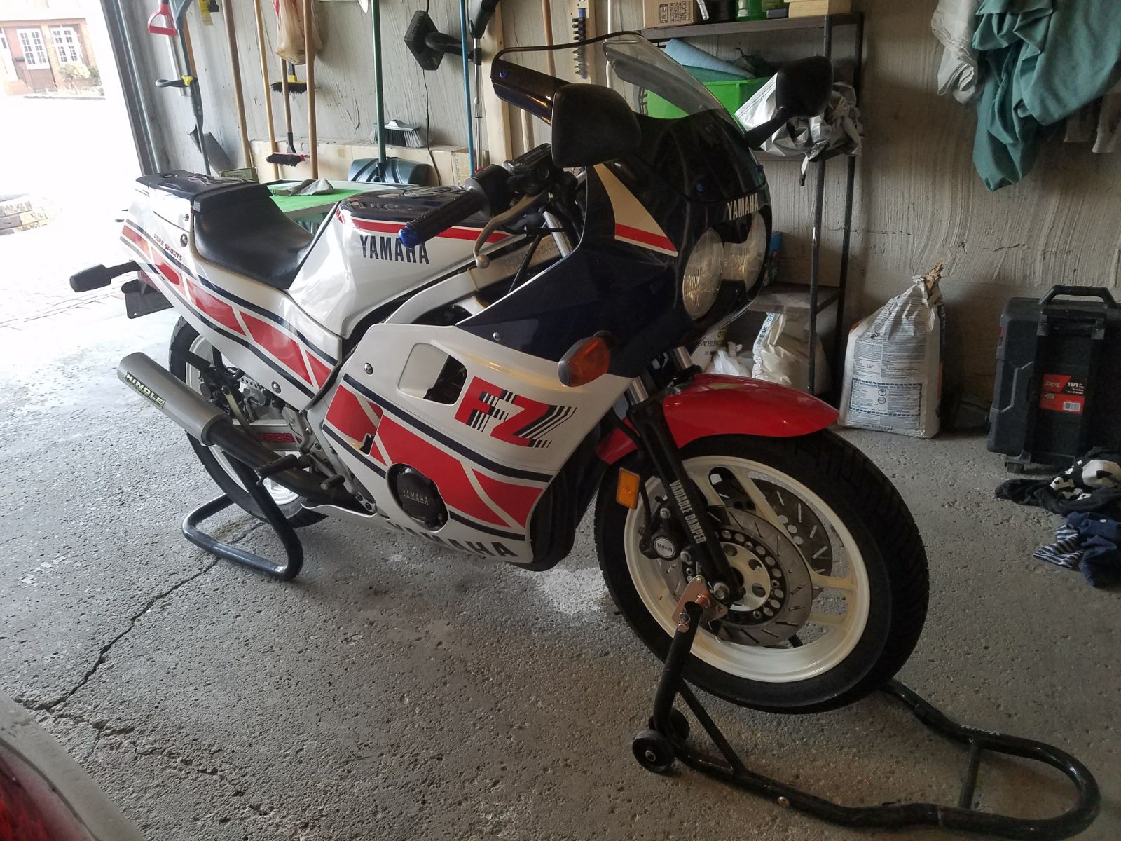

I have an 86 FZ600 that had been sitting in my garage for 25 years. I fully cleaned the carbs and jets, washed the tank, replaced all oils and got it started. It's still very hard to start without using starting fluid and there is afterfire from time to time when engine is still cold. I'd adjusted the air fuel mixture to a little to the rich side and afterfire stopped when engine warms up. Everything seems fine except that it still doesn't start without using starter fluid when cold. I'm thinking it's the valve clearance that needs to be shim. Does anybody know the factory specs of the valve clearance. I know the FJ600 specs is intake 1.1 to 1.5 and exhaust 2.1 to 2.5, just not sure if it's the same for the 86 FZ600. I just checked them today and they are at 0.2 to 0.8 on the intake side, 1.2 to 1.6 on the exhaust side.
I also changed to Hindle exhaust when I bought it 30 years ago. Just wonder if it needs to be tuned even richer to compensate for the straight exhaust.
What is the factory specs for idle rpm. It's at around 1200 now.
It's with IC ignition. Do I need to do timing on this bike, if so, how?
Thanks to all in advance.
