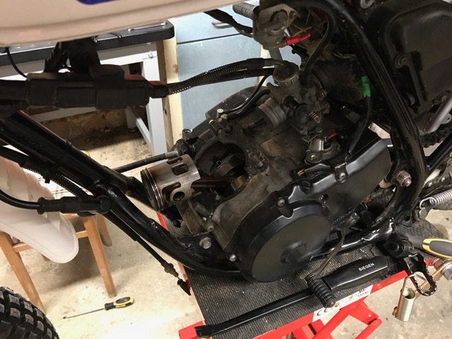

Noticed the DT was running rough on the way home from work, vibrations and a worrying rumbling noise lead me to believe it was worth taking a closer look.
Pulled the head and barrel off and found lateral left to right play in the conrod caused I'm guessing by a knackered big end bearing. I'll split the case and get the crank sent off to have the bearing replaced. Can anyone recommend somewhere that would do a good job of this? no where in jersey can do it so it will be sent to the UK anyhow.
