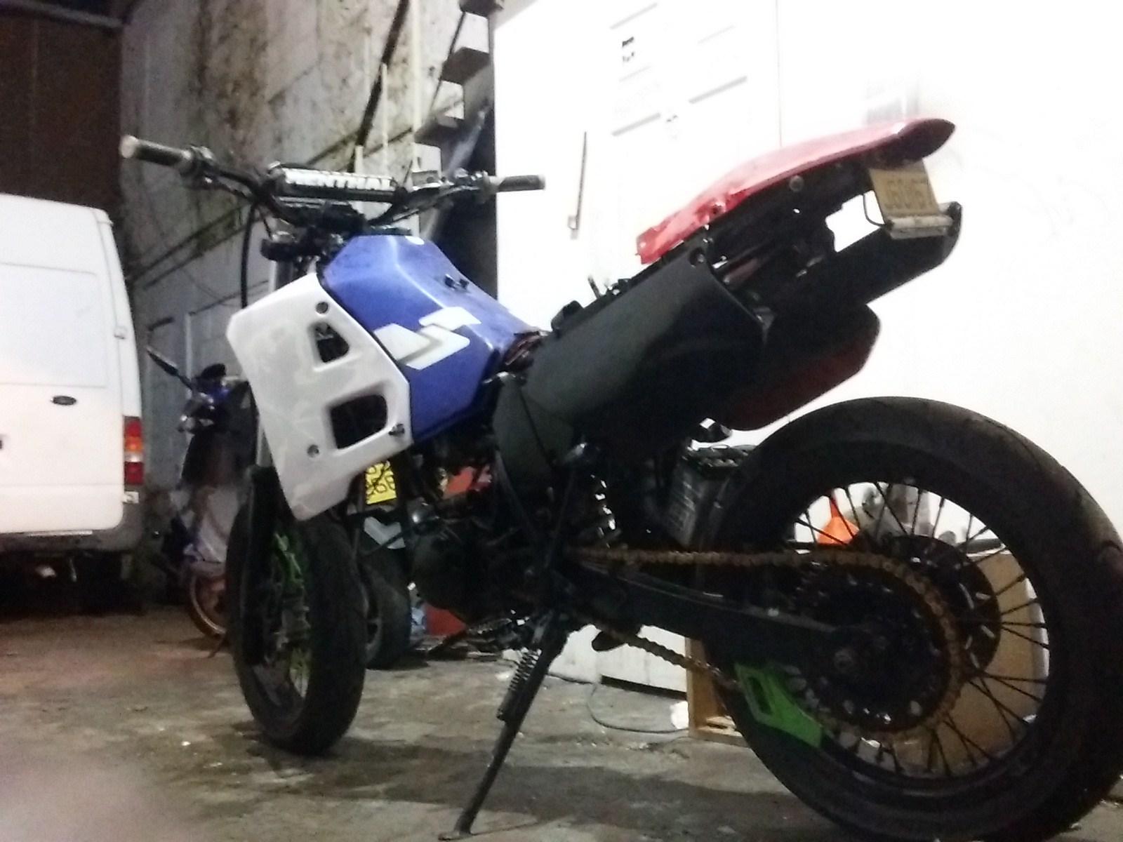

Hello this is my second DTx/DTr. So now if any one tells you that the body work off the DTr won't fit then you no it's lie's. If you wanna no how to do it then text me. I'm hafe way building my DTr/DTx making the back abit more smaller will let you all see more pictures soon.
Hopefully a motorbike manufactur see this or once I put my dtx/dtr on the road they will love my Yamaha and ask me to design a motorbike for them they won't regret it
Happy day'z
I call this Yamaha the Happy day'z DTx/DTr
