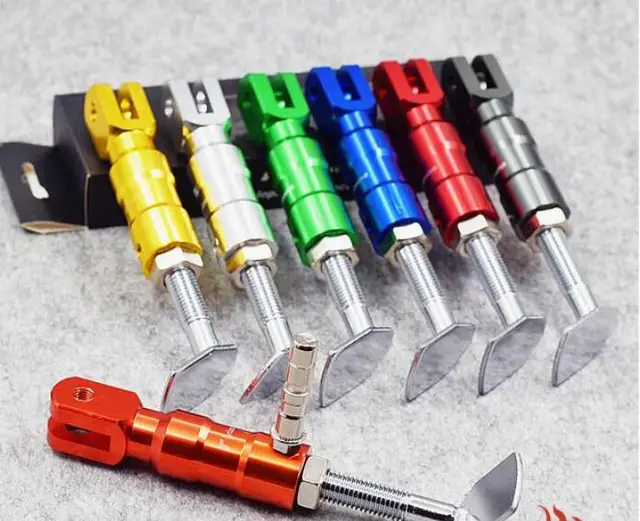

As Campaman said check the mounting to see if it's bent or twisted plus the frame where it bolts to the stand. If you really want to sort it try one of these sort of things
Image result for adjustable motorcycle side stand Fully adjustable and reasonably cheap. Think they are made in China but at only $12 dollars you can buy half a dozen. https://www.aliexpress.com/item/CNC-Motorcycles-Kickstand-Kick-Side-Stand-Motorcycle-Scooter-Street-Standard-For-Land-Rover-BWS/32828575903.html
Thanks for that, Bit i want to keep bike original so was hoping there was an xt250 owner out there who could just measure it. And another maybe 350 owner who might recognise the "strange" exhaust.
Nowhere near long enough for the xt, still looking for stand options for the daughters bloody Aprilia, still leaning against walls and using the paddock stand till we use it more when it warms a bit.
Now tried a couple of aftermarket units that either bend or are too short.
