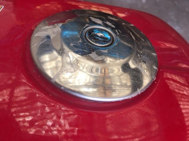

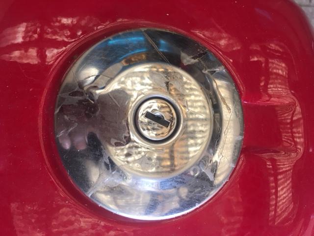

January 21, 20187 yr Author Hi Gents. Thank you for the replies. I tried Drewpy's advice, but it's not even hinting at moving. From what I can see, you'd need a pair of seriously strong hands to win that struggle. The larger of the two tools suggested by Slice may do the trick. I don't have one however... I'll be looking out for one. If that doesn't work, then I'm stumped. I can then only hope that my local Yamaha dealership will have a solution. On 1/19/2018 at 12:15 PM, slice said: Where are you in the world? Cos I have a set in the garage if your close and am more than willing to help out. I'm in Cape Town, SA Â Some pics for better reference: Â

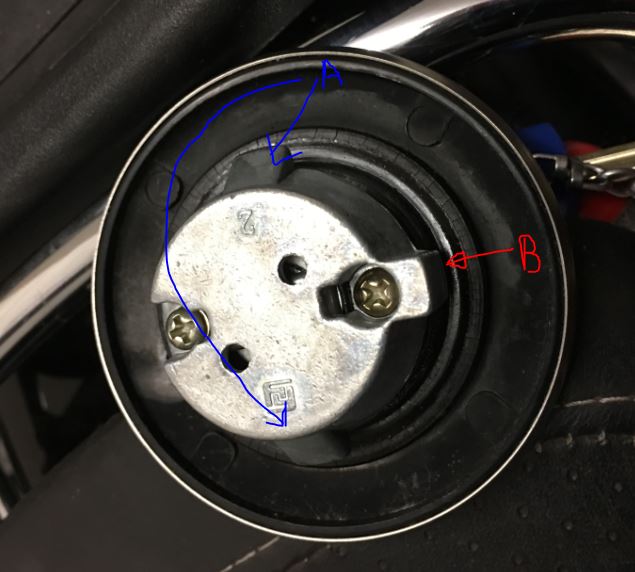

February 7, 20187 yr Hi, I have enclosed a photo of the underside of a 2010 YBR cap. The 2 lugs (a) retract on key turn to allow it to come out. There is a locating pin (b) which sets the orientation - if you got it in with this away from its slot at the 12 o clock position on the tank then I guess the cap needs carefully turned (probably with the key turned so the lugs are retracted to make it easier). Probably going to be a bit of a safe cracking exercise but mechanically its the only way if the locating pin is below the tank hole ring. Â
