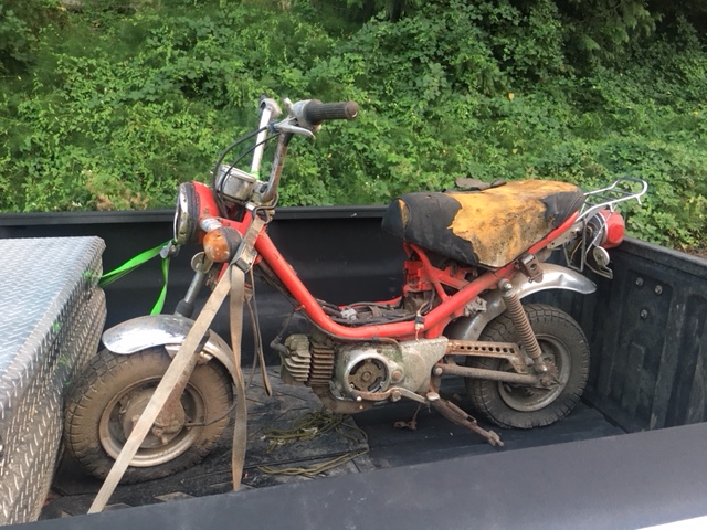

as for the non-runner, the cap on the side has been off for a few years and the stator is all rusty, *see pic*
I would assume that once its cleaned off it should spark, I bought new points for her just in case.

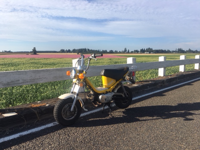

here is how the bike sits currently
