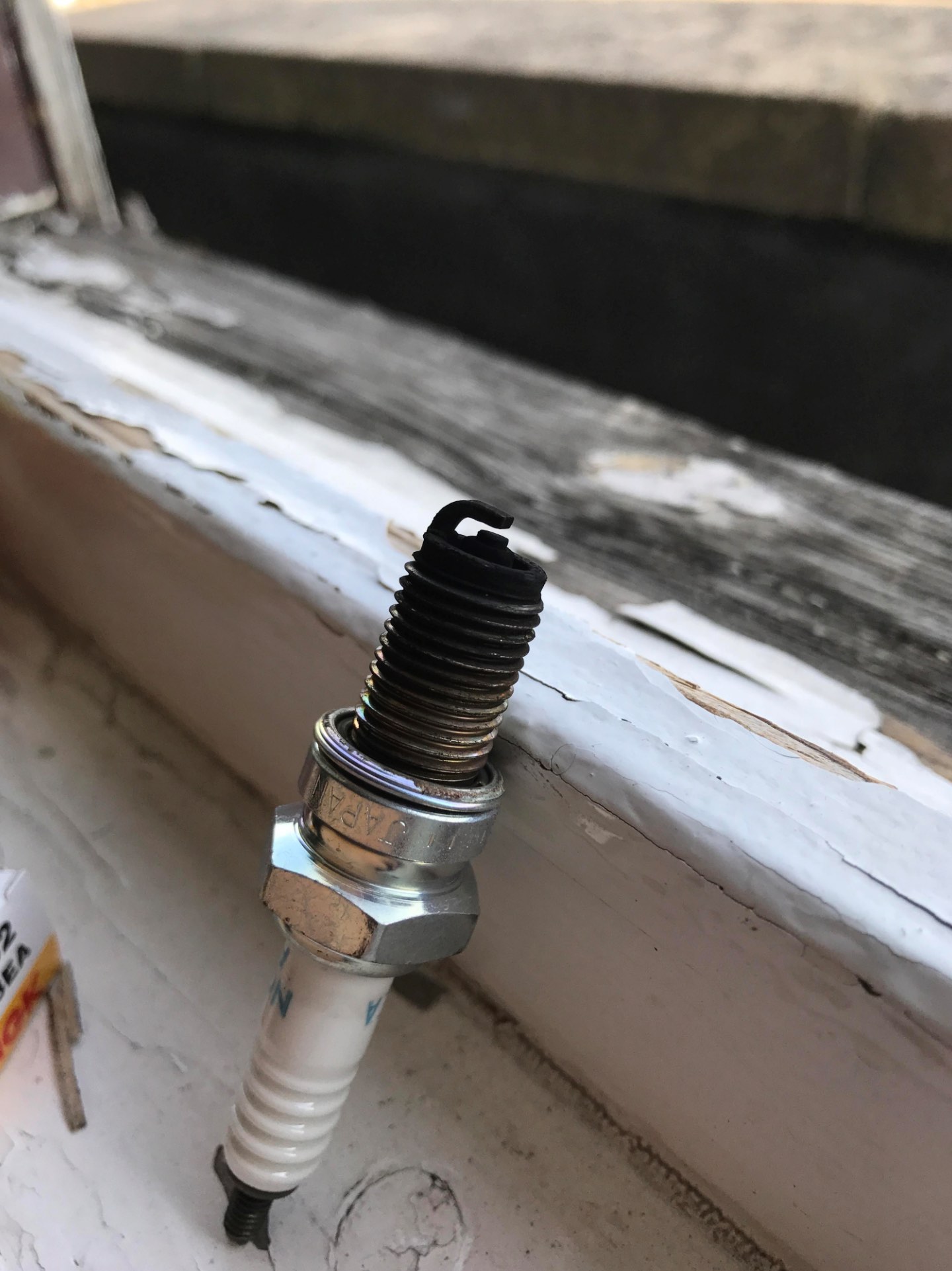

Checked the spark plug, black, sooty but not oily. Seems to run rich. Thought the carb needs inspecting, realised it's actually FI (you see how not qualified I am).

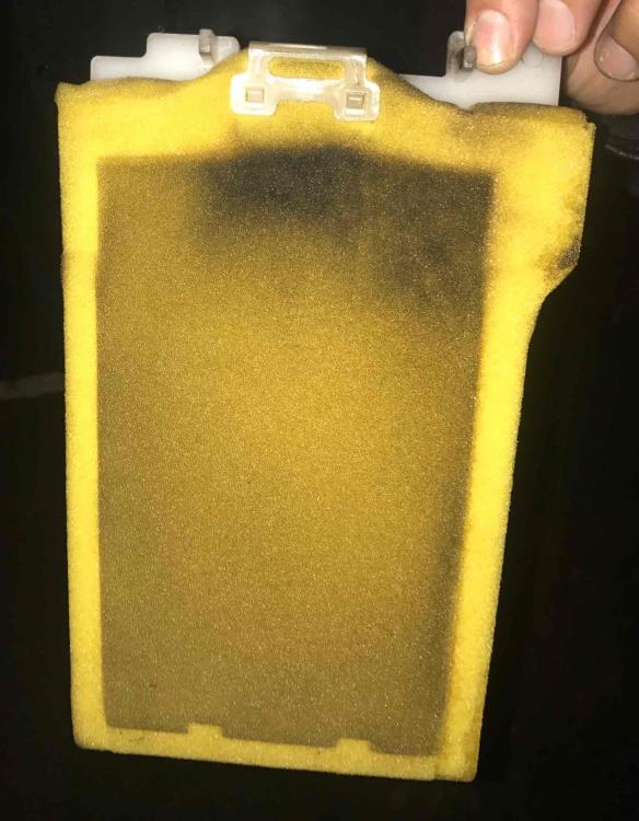

I then checked air filter (see photo), it's not clean, clean, but also not completely covered in dirt. We'll probably order a new one (don't have the cleaning supplies here).
But I still have my doubts the air filter caused all of this? Any other YBR 250 owners here, or someone with actual mechanical knowledge? Do you think this is clearly the air filter causing the ECU to richen this up, or could that be anything else?

Easiest test first. Ride it without the filter and see what happens.
Next one is a question. Does it smoke at all.
Thanks for the quick response, you reckon it's fine to run it without a filter (for a brief test ride only I mean)? Not entirely sure what may be pulled into the engine there? But that would at least sound like the most straight-forward test of all indeed.

Yes dont go touring France but a short ride along a road you use a lot so you know how the bike normally feels.
It will make it louder. Its one of the less obvious air filter jobs, silencing the intake noise.
Just took out the air filter, tried it again and if anything, it may have gotten worse even (also in 2nd gear, serious jumping back and forth). Seems to happen more in lower revs, when throttle is kept constant.

I did notice quite a petrol-smell today, may have been other things on the road, but just road it for a bit and it kept following me it seems. Spark is brand-new.

Me. Im going with a leaky/worn injector or a compression issue. Have you checked its a really nice bright spark.
The bike running worse means the fi detected the change and compensated adding even more fuel. Componding the problem but also focusing it too.
