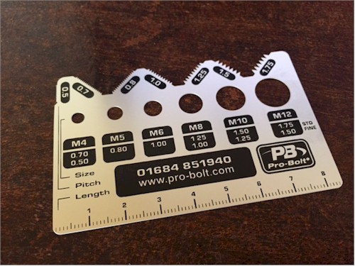

Forgive me if this post isn't news but its been a while since I tinkered with bikes so I'm posting anything I find useful. Had to hacksaw off four non standard bolts from the rear frame. They were supplied by whatever company sold the back rest they were holding on. I needed to replace them but had no idea of the size or thread pitch, the standard Yamaha bolts would of course be too short - Then I discovered this handy little gauge. I think its self explanatory.
Bolt sizes/threads (external) are easy enough to measure with just a steel rule (larger sizes) or a Vernier gauge, pitch gauges are useful for internal threads where you can't get a rule or vernier into them, the ones on that gauge are only any good for external threads though.
Still a useful gauge for quickness though.
Point taken Campaman however . . . . my problem was I didn't know the size of the internal thread but finding a bolt that fitted and measuring its external thread with the gauge gave me the answer. In essence, I used one to find the other.
