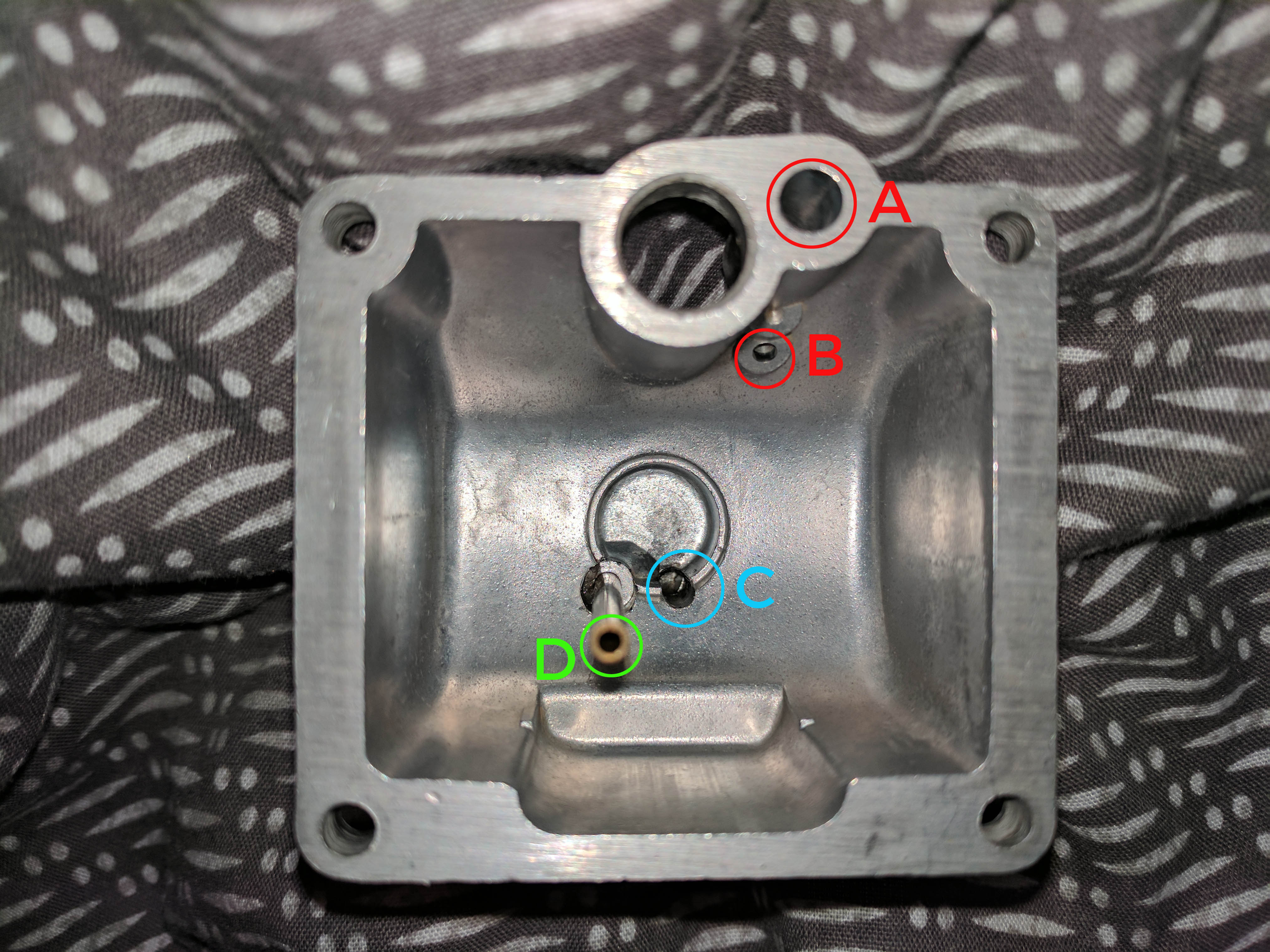

April 30, 20178 yr Ok, Â am thinking, the choke system isnt working, , Â the flaot bowl has a small well, Â and a bras pipe dips in there, thers a small pinhole at the bottom , that feeds the well, Â see it in this pic,Â

May 1, 20178 yr Moderator so the little hole between the choke well and the bowl is clear then is it? if you fill the well with petrol...it passes through into the bowl?
May 1, 20178 yr Author R1Junky - I'm pretty sure the camchain is fine... it has very good tension and everything seems to match up nicely at TDC on compression stroke. I thought maybe the valve just hadnt been done up tightly. not sure! One thing that tripped me up though was my bike has an automatic camchain tensioner which isnt mentioned in the haynes manual, but after some research they were apparently added in the later models. (mine is a 2003 which is the last year of manufacture) is there an easy way to check the CDI? Â Airhead - Yep! IÂ sprayed carb cleaner in through point A and it came straight out of point B, then tested it with a small amount of petrol which disappeared down through the pinhole. I also checked points C and D as well all is clear. hmmm!
