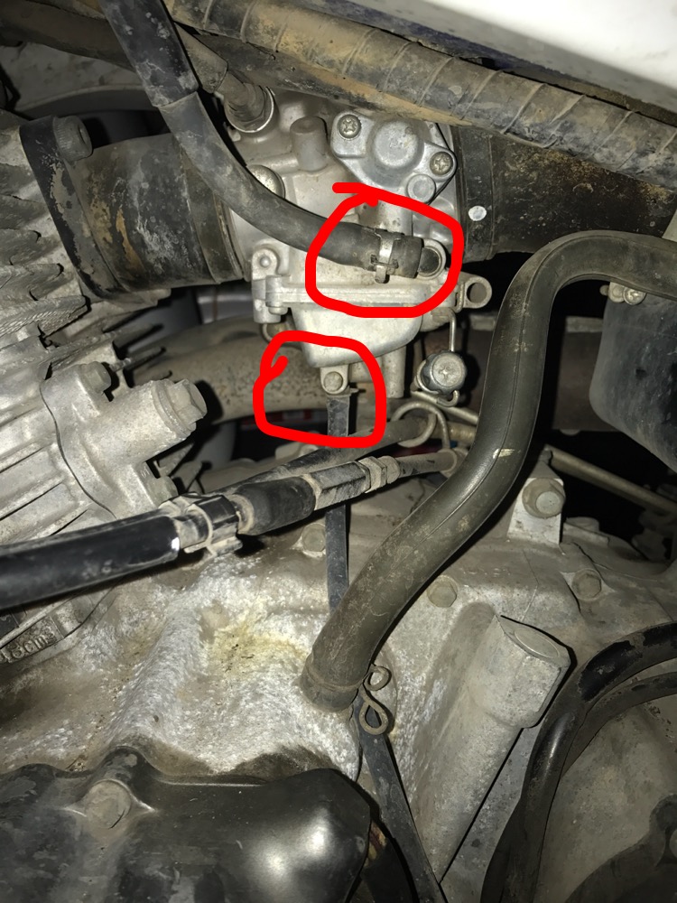

Is the top one the right one to train from? If so how do I pull it off even with taking off the metal clip it seems impossible
Yes it's the top one, take off the metal clip and try twist and pull or just pull it hard, it will come off, or to make it easier, heat the rubber where the metal clip was with a hair dryer or heat gun or can even pour boiling water on it to make sofen the hose and will pull off much easier, but with a strong pull it will come off

I've slipped the bottom screw on the carb but I emptied it from the fuel tube from above, is it possible for a mechanic to open the carb still with a damaged screw I'm worried I've ruined the entire screw due to ruining the screw

Fuel that old is bad news, if its gone yellow then its at least 12months old and only fit for cleaning parts.
More importantly, the fuel in the float chamber will have evaporated, even more so with your climate. This forms a white crystalline type crust over everything, quite stubbon to remove but it will be throughout the carb. It doesn't dissolve back into fresh fuel either, the only way to clean it is get in there and do it, there is no magic sauce, there are stabilisers you can use BEFORE standing the bike for a long time. Draining it out is better, its one of the reasons why the carb has a drain screw.
You really do have no option but to remove the carb and any filters and clean them properly. There will be bits floating around in the carb randomly closing off or reducing jet sizes and passages in the carb,

Thanks I'll be getting a mechanic to clean it, do you think he'll be able to since I've ruined one of the screws?
