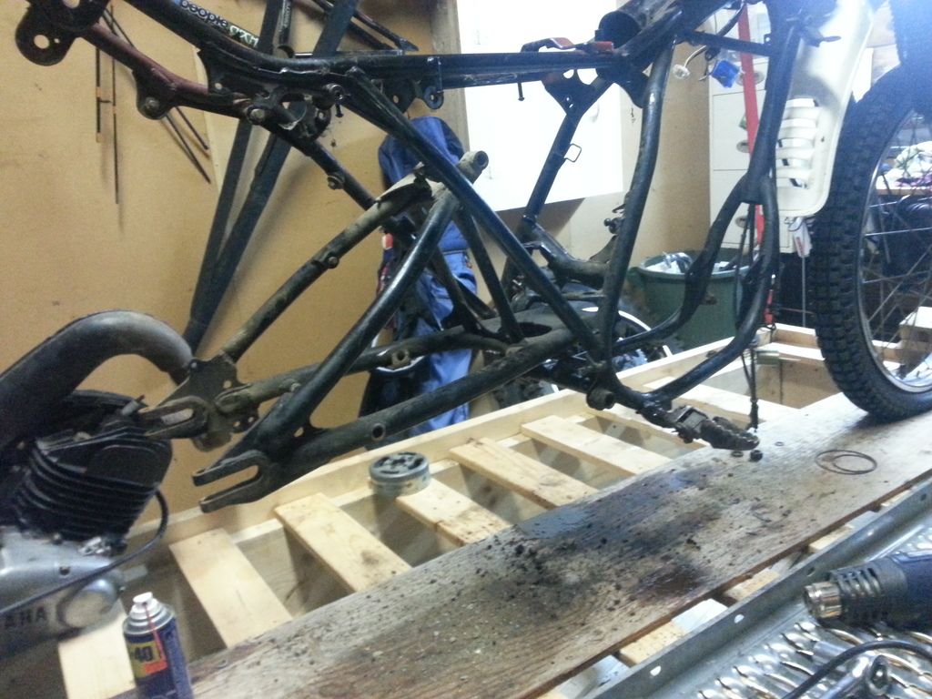

Over the last couple days I got into it hard. I decided I'm going to sand blast the frame and re paint it, so I started the tear down. Got the engine out and the bulk of the rear end stripped down.
I'm at a stand still now though, because I'm having a serious problem getting the swing arm pivot pin out. Its seized pretty bad and it takes almost all of my 190lbs standing on the ratchet to even turn it. The nut came off easy enough, but so far heat, WD40, and hammering wont budge it.
The swing arm wont even drop under its own weight... Anyone have experience with this at all?

It's a common problem, the usual way is to saw through the pivot bolt to get it off !
Yikes! I'm a little uneasy about getting an angle grinder anywhere near there. There isn't enough room for the blade between the frame and swingarm
not an angle grinder mate, a hacksaw blade and patience is whats required ;)
Oh boy... I'm really looking forward to that now haha
mine was stuck many years ago and I got away with it by putting a stout tube over the head of the pivot bolt and putting the other end of the tube against a wall, then rep[lace the nut flush with the end of the bolt (washer removed) and strike it with a heavy hammer to move it, it might work...it did for me.
I think tonight I'm going to try laying the frame down on the floor, support it from the under side, then trying the WD40 and a hammer again. If that doesn't work, I have a friend with a press that I might ask for a favour.
Had to cut mine. Hacksaw blade without the hacksaw, wrap some tape around one end and start sawing. Its not that hard and you make progress quick enough. Luckily its not a hardened part. And there is a gap, you need to cut through the top hat nylon bushes between the frame and the sw arm. Gives you enough room to get the blade in.

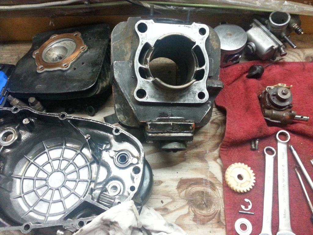

Spent yesterday tearing the engine down. The PO told me he "rebuilt the engine" before he traded it to me, but after he also said he "took all the best condition parts from the three engines and put them into that one" I knew I needed to check. Good thing I did. Re-used rings and gaskets, changed out the cylinder without even a hone, heavily greased the connecting rod bearing, and a seized oil pump. This project is something else :blink:.
Then, to add insult to injury, I took the frame to my brother today to have him press out the swing arm bolt. He did a rushed job and somehow cracked the top tab in two places. Didn't even push the bolt all the way out. Turns out he was late getting to the gym... still need to get the bolt out completely to really assess, but I might be doing some fabricating and welding of a new tab in the near future.
Most of the shiny spots are just removed paint with no actual damage, but the cracks are concerning. Lesson learned. If there's a next time, take it to the professionals. It'll be worth every penny.
Your not the first to be sold a 'rebuilt' engine thats a dud.
Looks like your in control now though.
