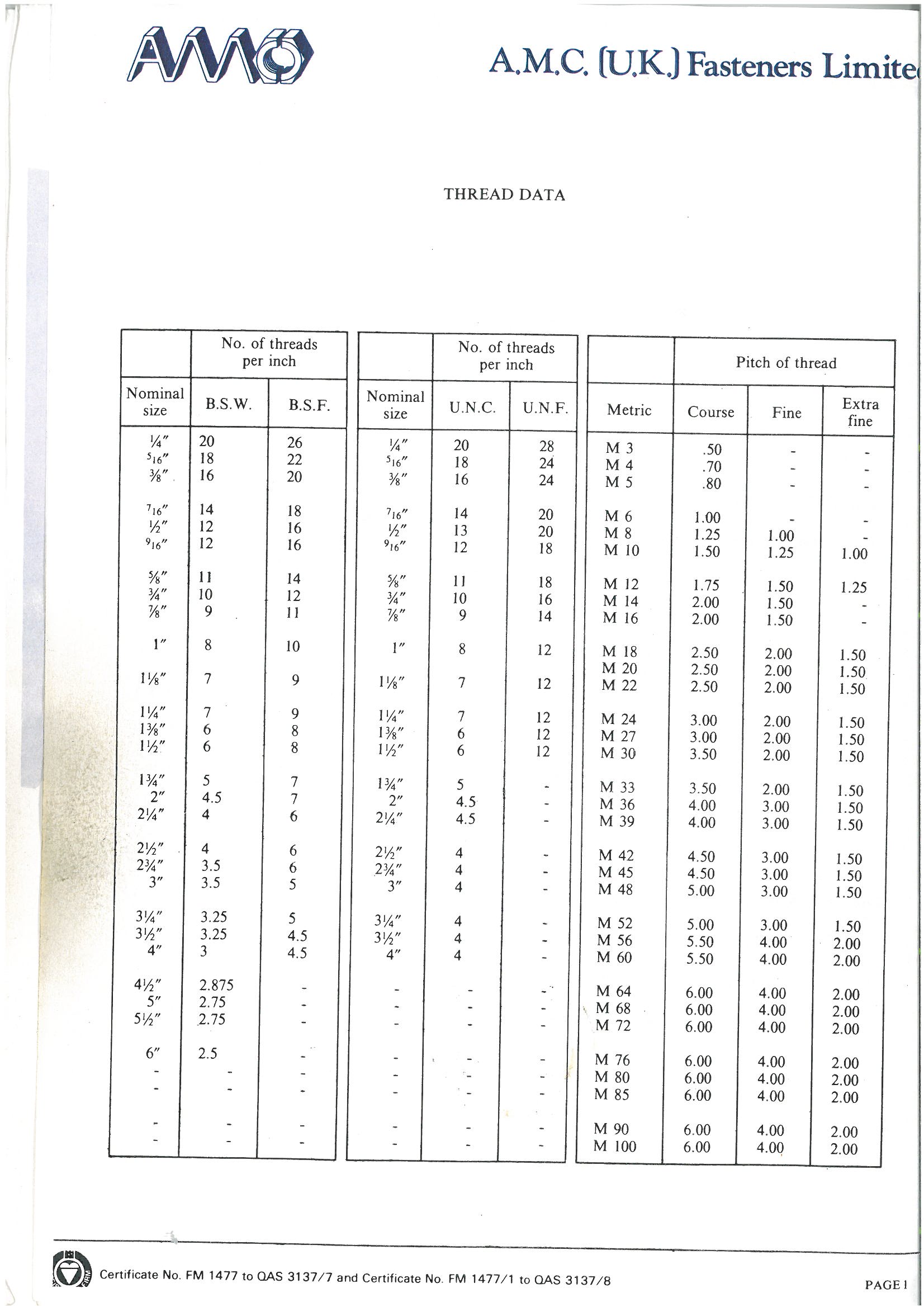

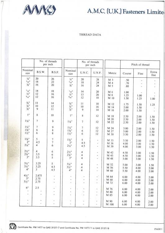

if I have done this right this should be a scan of our catalogue page that gives all the thread pitches including extra fine, I work for a Nut manufacturer so anything you need to know just ask.

Thanks people that helps a lot ta.
